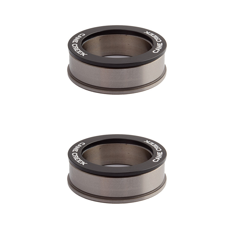

Anyone running one of these? Specifically the PF41 version?
My 2019 Jeffsy has done 250km, 95% of that in slop and mud, and the BB is starting to feel a little rough, like there's not much grease in there. It spins fine, and doesn't creak, just feels a little 'loose' if you get my drift.
It's a BB92 (PF41?) with a 30mm spindle on the E13 cranks, so I'm very tempted, whilst we're in lockdown, to replace it with a Cane Creek Hellbender BB with those fancy new SKF MTRX bearing which should be able to survive a nuclear strike/zombie apocalypse/UK winter.
If you have no idea what I'm talking about:
https://youtu.be/quK5L0vIGjU
It retains the balls, whilst providing constant lubrication. Sold!
Also, what headset/bottom bracket/bearing press kit that I don't need a 2nd mortgage for?

As above, you can't replace the bearings only on the PF41 model, as they're part of the BB.

The CC PF41 BB comes with these sealing rings so should be a lot better in keeping the crap out. I may check and if there's a drain hole in the frame I'll remove the sealing tube as all it seems to do is keep the crap right in the BB.

Well, you definitely don't get a lot to show for your £120, that's for sure.
[url= https://live.staticflickr.com/65535/49742614211_f678d792a1_b.jp g" target="_blank">https://live.staticflickr.com/65535/49742614211_f678d792a1_b.jp g"/> [/img][/url]
[url= https://live.staticflickr.com/65535/49742936287_2f0b8615d7_b.jp g" target="_blank">https://live.staticflickr.com/65535/49742936287_2f0b8615d7_b.jp g"/> [/img][/url]
[url= https://live.staticflickr.com/65535/49742936372_4bc9e6a864_b.jp g" target="_blank">https://live.staticflickr.com/65535/49742936372_4bc9e6a864_b.jp g"/> [/img][/url]
But there is £40's worth of bearings in there, plus the BB shells, plus the end caps, so it's not too bad.
Turning the bearings by hand, there's a definite 'tightness' to them, they're not what you'd call free running, but they are very, very smooth. You can almost feel the insert and the lubrication, they feel a little different to regular bearings.

Check it's definitely a hellbender, it has writing on the seals on mine.
[url= https://i.postimg.cc/4d72hcG2/IMG-20200406-173218.jp g" target="_blank">https://i.postimg.cc/4d72hcG2/IMG-20200406-173218.jp g"/> [/img][/url]
The 'Neo' name comes from the MTRX name of the bearings. The Matrix, Neo, innit.

No - if you mean a PF41, 30mm spindle BB then the outer race on the PF41/30mm BB is also the Pressfit cup, on the normal bearing it's a 42mm OD race with no flange as per the PF cup.
There's no room for a seperate outer race on a pf42/30mm BB.
Also, PF41 BB bearings are 11mm deep, those 30mm MTRX bearings are 7mm deep.

All fitted in my lunch break.
Easy job with the right tools, I reckon I could replace one in 40 minutes, easy.
It's soooo smooth! I was going to re-use the E13 sealing tube but then I though that if the dirt was getting in via the bearings, all that would happen is the sealing tube would keep the dirt in the BB right next to the bearigs, so I left it out.
Wasn't enough room to fit the ally dust covers, I think they include them with all the BB's but they don't nessearily fit all of them.

So running mine, over a year old and still running as smooth as the day it was fitted, zero issues.
Posted : 24/05/2021 10:11 pm
Posts: 5661
So I take that back, a few wettish days in the Lakes appears to have killed it 😕
Bit of play stayed to appear which I couldn't get rid of with the preload adjuster, got the drive side crank off and it's the bearings that have the play. Can't get the spindle out though, it appears welded on!
So that's around 6 months for the original e13 BB, and 1 year for the cane creek mtrx BB. I think a 24mm BB and new crank is in order, XT 12 speed with a hope or Wheels manufacturing PF BB. Maybe I can get 2 years out the next one?
Posted : 31/05/2021 5:01 pm
Posts: 13771
Hope 30mm BB? Suspect it will outlast both.
Posted : 31/05/2021 5:56 pm
Posts: 5661
Nah I'll probably look at swapping cranks to a 24mm shaft, I think it's the inherent problem with 30mm cranks in the press fit shell, there's just not enough room for good sealing.
The hope 30mm pf isn't much different to all the others, the 24mm one obviously has much bigger bearings and screws together.
Posted : 31/05/2021 6:30 pm
Posts: 1725
Hope 30mm PF92 dont last either.
Putting a 30mm spindle in a 41mm hole does not leave much room for bearings and is a stupid idea.
