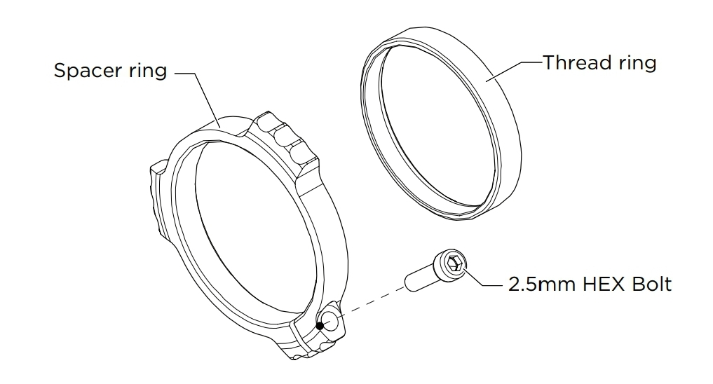

Can any point me in the direction of where to get my hands on a replacement bolt for the above?
Ths little chap:

For a 2.5mm Allen key head, size is M3  it would be a socket head cap machine screw.

It’s not clear on the instructions, but my interpretation would be - 2.5 hex bolt,  would refer to the tool being 2.5mm, not the bolt.
A M2.5 bolt with a hex head (socket cap) would be a, hex head, 2.5mm bolt.

ExtraUK aren't listing the bolt as available as a spare part, only the complete ring including bolt @ £32.99 in various colours. The bolt is described as Grade 5 Titanium 2.5mm hex fastening bolt

It’s screwing into Aluminium, stainless is fine, you want M3x19mm

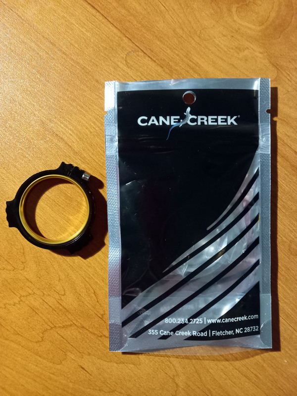

No virgins involved, just the postie, but I've just taken delivery of a replacement Pre Loader - no questions asked.
Tip top customer service.
