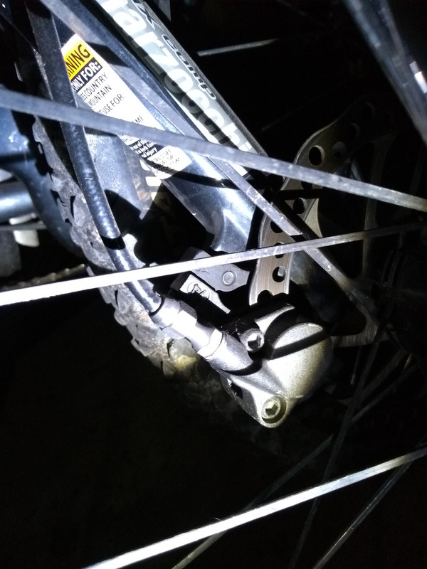

Just took my brakes off to do the forks. They need pads, but they seem to have been leaking a bit. Maybe slightly oily on the back of the pads, and the brake dust looks oily and is caked on around the caliper.
However they were fine in use, when I squeeze them hard (much harder than I would in use) clamped onto an allen key there's no visible leakage.
Is weeping a sign of imminent failure or can it be lived with?
They're BR-M785

I have a few bikes this has happened on (all shimano) at one point the oil will make it onto the pads.

You can live with it for a bit - I have a front brake with a microleak that I did plenty on in the Alps recently. Obv I sorted it as a priority when I got back.
The O-ring fix is much discussed and is pennies - if that is the actual problem. If it's the pistons then an aftermarket kit is available but not worth it for such an old brake.

You probably have driven a car with the calipers leaking as much as these are. You would never know.
Pads were very worn so it's possible they only leaked a bit on max extension.
I haven't checked out seal kits, could be a good idea.
This is the crucial bit. I'd clean them up and go for a ride. I'd certainly not just bin them without checking.

Isopropyl the callipers and discs, sand the pads. Try again and see how long til braking performance diminishes.

I have the same calipers BR-M785 and mine started leaking but the bike has done almost 20k miles so I think I got my monies worth. Before changing the calliper, my bike would stop but it was far worse than normal and the squealing was horrendous and it was the squealing that I couldn't live with. Changing a caliper was far easier than I anticipated and I found the same caliper at a good price. I took the caliper apart in an attempt to replace the orings but my lbs didn't stock them and considered Shimano / sram calipers as consumables. Good luck

I have had the exact same problem with brm 785 calipers. I found the slight leak was causing screeching when wet and less power in the brakes. I swapped out the calipers for some xt calipers I found which were post mount and not flat mount as most new ones seem to be. I had to get 2 banjo fittings as the originals had a straight compression fitting. They have been great, silent and just work as they should with the original leavers. My advice is you need brakes you can rely on - get them sorted

I had shimano brakes on my computer bike.
They frequently had leaky calipers, this normally resulted in lack of braking power and a howling noise.
I used to just ride the bike until I felt motivated to do something about it.
Sometimes a month or two.
I never had any sort of grabing from the brake, just howling and lack of performance.
