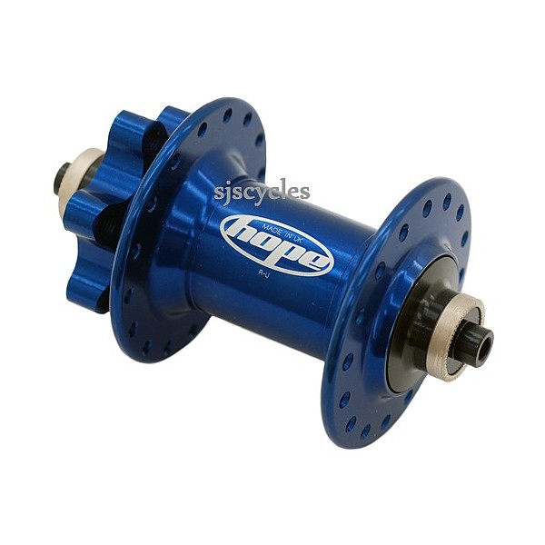

I need to know the exact size of the hole a front or rear QR needs.
I'm getting some step up adapters made to convert a QR to 10mm to allow me to build some wheels in a normal QR jig but I forgot to measure the size of the hole I will need.
Eg the inner diameter of the hole on the right that the QR goes through.
Thanks

according to my verniers its 5.2mm*
*i think they're accurate. if you call hope theyll tell you the actual size. 01282 851200

My hope QR adapters are hex shaped internally. Near as I can measure the hole varies from 5.2 - 5.4mm.

That's on a Pro III. And front BTW.

i believe the pro III screws together to preload the bearing. hence the hex head.
[url= http://www.hopetech.com/webtop/modules/_repository/documents/ProIIIFrontMono-Assy.pdf ]as seen here[/url]

Standar QR skewer is 5mm if that helps
