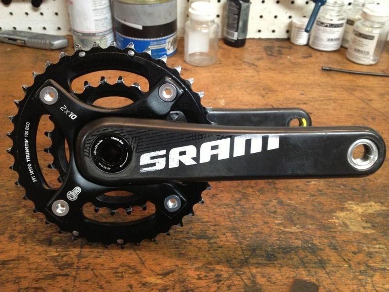

I currently have a SRAM 0x double.
can I use this chainset, change the ring for a sram 11 speed and change the rear mech and chain?
would this work?

I'm using a 10sp X9 double with mine, it's all the same really. Some chain line potential issues with a double but not much? Is it a removable spider? If so go direct mount and it will line up right.

not sure about the spider. all I know is its the 0X with carbon arms. direct mount...will look into that.
need to check I can get a 11spd ring with 104

Mine is a mix of XT shifter, mech and cassette with sram chain and cranks. Works fine. If it's a X0 crank the whole spider should come off, there's 3 bolts on the back. You can then fit a direct mount chain ring

You dont need a specific 11sp ring, any 104bcd NW will work

so if I can fit Direct mount chainring. I can install an 1x11 setup that works perfectly (chainline wise) like a full 1x11 groupset?

Yes, though I'd go sram cassette lighter bigger range and now that much more for gx.

this is the crank

I have the same cranks. I use a direct mount oval ring, the rest of the drive train is sram GX 11 speed and it works perfectly.

looks like the direct mount sram ring is only 28t (I ideally I was looking for 34)

found 34 t ones but more expensive
does it matter if I have BB30

Compatibility chart here helps?

hm, not sure If I have a long spindle or short spindle bb30 ?
also will an 11spd cassette be cool on a 10spd hub?
