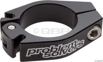

Posts: 507
You may also have problems with the lack of a rear cable stop on a GT of that vintage, zip-tieing a full length outer to the frame will solve that one (clamp-on stops were available at one time, but I suspect your frame will ovalized in the area it needs to be clamped).
Posted : 26/03/2014 6:55 am
Get a seat clamp cable stop hanger. I have one that goes on the bolt on the seat clamp of my steel cross frame
Posted : 26/03/2014 7:04 am

 JoeG
Use one of these on your top tube for your rear cable stop.
[url= http://www.amazon.com/Problem-Solvers-Backstop-cable-slots/dp/B001CK2NXE ]Problem Solvers Backstop[/url]
Posted : 27/03/2014 4:59 am
