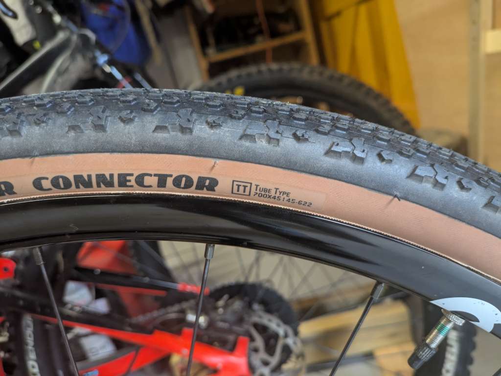

I'm new to gravel, I've only had my Camino for a couple of months, but I'm loving it.  However, one niggle - I'm getting quite a few punctures.  I made the daft error when ordering, of not ticking the tubeless option. I've run my mtbs for years tubeless and can't remember my last puncture, so the 3 or 4 I've had in 2 months seems excessive to my mind and I'd like to ditch the tubes!
I'm a bit too skint to buy new tyres right now.  I do however have tubeless tape, valves and sealant to hand. So until I source pukka tubeless ready tyres, can I run my current tyres tubeless?  Even though they are marked "tube type" and so not presumably designed to be run tubeless?  Will it work and is it safe?  Current tyres are Goodyear Connector 700c 45mm. The wheels are Sonder Alpha with (I think) 21 or 22 mm internal width, and supposedly tubeless ready, but they've been taped badly with some uncovered spoke holes so would need redoing. I suppose I've got nothing to lose by at least seeing if they seat and hold air before putting sealant in?  I've seen mixed opinions online about this from "crack on it's fine" to "you'll die"!

If they're not tubeless ready, I doubt that they'll hold air without sealant. They might work with lots of sealant sloshed around inside to seal up but you won't know without trying.
Are they definately marked "Tube type"? The Goodyear site only lists "Tubeless Ready" or "Tubeless Complete" as options for the Connector.
Posted : 01/02/2025 1:34 pm
Posts: 5354
Are they definately marked “Tube type”? The Goodyear site only lists “Tubeless Ready” or “Tubeless Complete” as options for the Connector.
Yep. Maybe it's an OEM only variant?

It can be done, but a non-TL tyre doesn’t have a bead designed to take the increased stress. If the bead stretches and pops off the rim then it’s often toast. Worked as a bike mechanic and found out the hard way a few times that it doesn’t work all the time, including cleaning tubeless sealant off me, the walls and the ceiling.
Posted : 01/02/2025 2:22 pm

You might need to get a bit of sealant in to see if they'll hold air though. I had some tubeless ready Vittoria's with tan walls and they took 3-4 days and lots of sealant & spinning before the sidewalls sealed up.

And then decided life is too short and bought the tubeless version of my OEM tyres. Goodyear Connector Ultimate Tubeless Complete 700 x 45. £29 each from Tredz.
Good tyres, I've been running them a couple of years on my bike. I'd have tried the original ones first TBH, but then at least you're less likely to be stranded miles away from home when one goes wrong.
