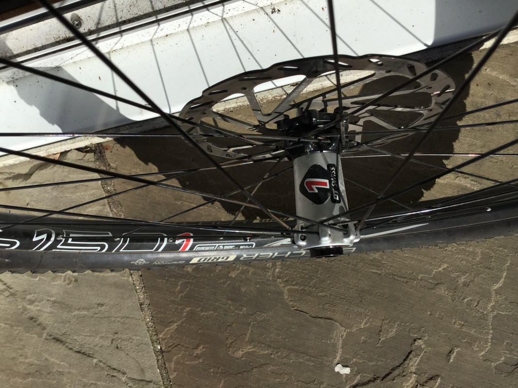

Dt swiss spline 1 that are currently 100 and 142.
Looking at a new bike that has boost spacing. Is it just an end cap swap? If so can someone post a link to what I need front and rear?

yes, but you'll need the disc/rotor spacer kit too which is about a Fiver. They're basically just spacers of 5mm on the front on each side..

Generic kiss are available on eBay, but can be a faff with spacers falling out on wheel changes. MRP do a 'better boost' kit for DT, is relatively expensive but will thought out.

Wolf Tooth Boostinator another option, they do DT specific kits

For the front MRP better boost. There are two versions depending on what your hubs are based on (either the max 15mm 350/240s or oversized 240 that goes to 20mm). The MRP pages has more info including measurements. From the limited view on the picture the front does not look like the 15mm max version though hard to be sure. Better boost kit does not require a fishing change.
For the rear wolftooth do a replacement NDS end cap and rotor spacer for ratchet hubs. This puts the cassette in the right place but requires a re-dish of the rear wheel. Again not cheap. There is an alternative kit available from Germany which is a bit cheaper and does the same thing with longer end cap.
I'm assuming the spline one is based on either the 350 or 240 hub. If it's based on the cheaper 370 pawl hub probably better selling them than throwing money at expensive spacers.
