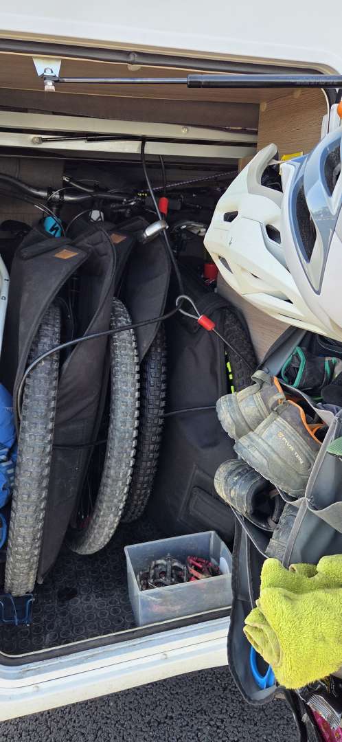

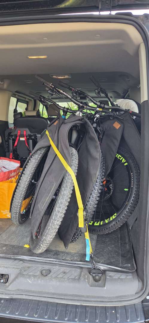

Ours are in bike shrouds and one ratchet strap across them all. Easy to put in and take out. No wasted space and no damage to bikes or van
Same in the camper but no need for the strap

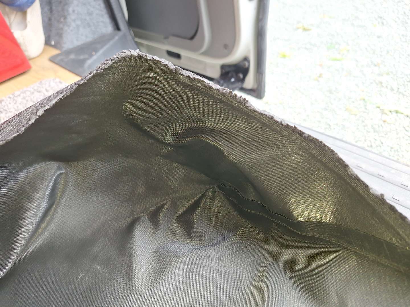

We have taken a different approach to carrying bikes inside the campervan.
We (ie the Better Half) made a cover to go over the rear seats for when they are in bed mode. The cover is made of a waterproof type canvas material with all corners and sides cut and sewn so it fits snugly down all sides approx. 6" which means it barely moves when loading a bike. I remove the front wheel, use an offcut to sit the rear wheel on when sliding the bike in, otherwise the tyre catches badly, the front of the bed is raised slightly and the front wheel fits underneath the bike.
Works with mtbs, hybrids and our tandem.
If I'm just off somewhere to mtb I fit a large piece of cut cardboard along the side of the cupboards/kitchen to minimise the risk of damage to them. The area I have to be most careful with is the first vertical corner of the cupboards when loading from the rear, so I lower the dropper seat but raise it once loaded.
The cover means we can shift other quite large items with minimal risk of damage to the campervan.
Pictures of material and a corner below.

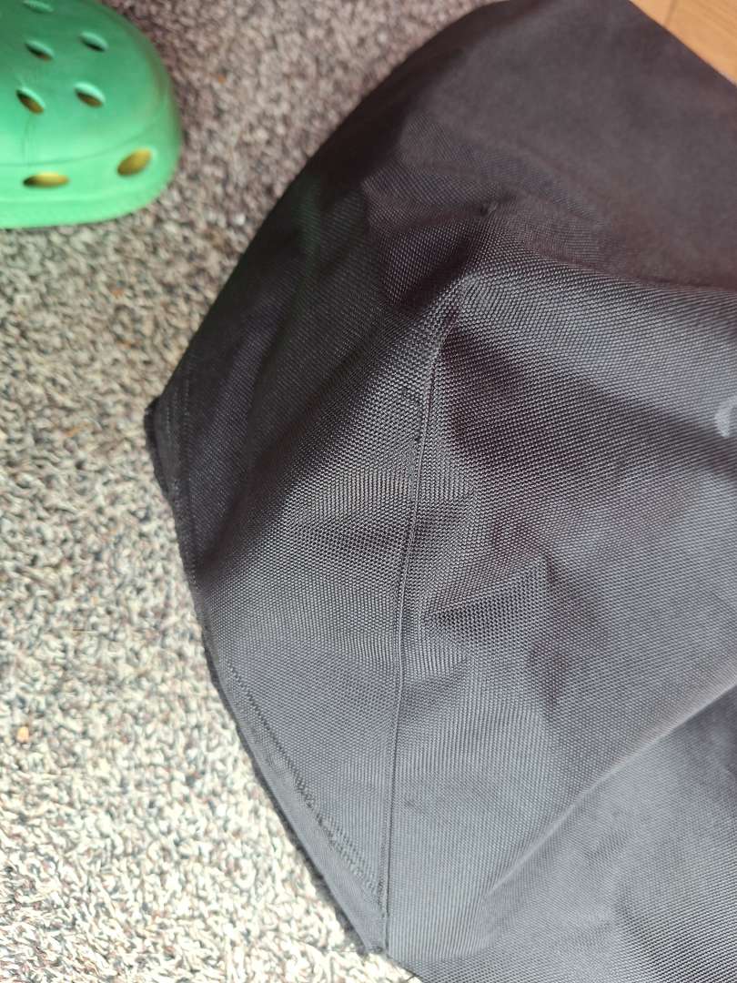

Posts: 774
Edit: for some reason one of the pictures does not show properly on my phone. So 2nd attempt below ..

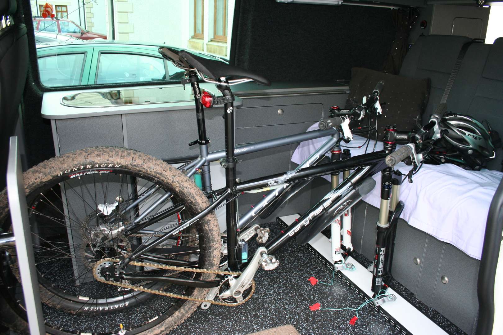

That approach, but with a wider/longer board for added stability worked for us with our camper. Instead of rubber backing, we used heavy duty sticky backed velcro: stick the furry side to the camper floor and the hard side to the bottom of the board. Worked for us for 2 bikes without any additional strapping etc. Didn't need much velcro either, just a few strips and wasn't that noticeable against our black sparkly floor.

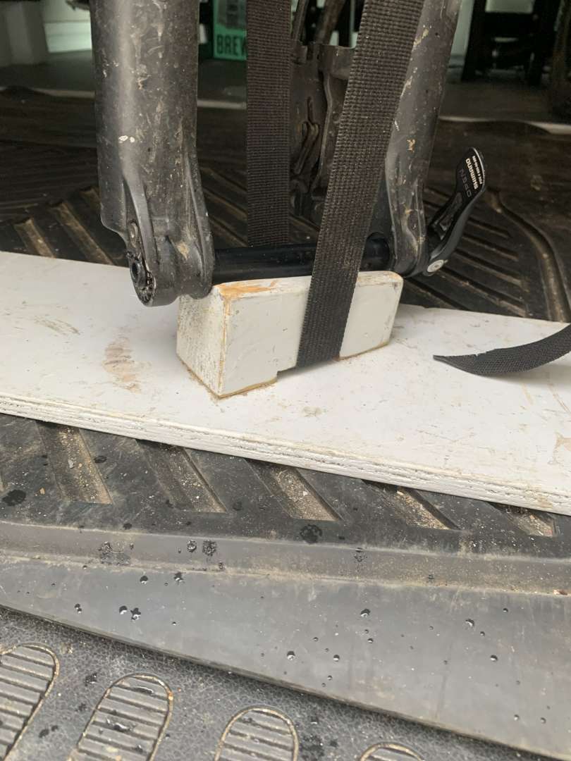

This works well in our van to minimize the overall height for increased bed space, while allowing quick setup. The mounting blocks are angled and beveled to reduce handlebar overlap. A single cam strap over the bar and under the block compresses the fork and provides a solid anchor (works with rigid forks to). The V notch on the block top takes 12-20mm axles and I have a dummy for QR forks. I made them out of soft wood and coated with epoxy for durability, but hardwood would work well. Two of the blocks are fixed to the plywood base and I have since made others that can float, depending on packing.

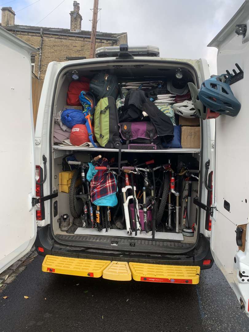

Posts: 3297
IMG_4791.jpeg IMG_4791.jpeg  IMG_4791.jpeg Not my picture, but this is what I’ve gone for now.  I did have the brackets on a shelf/bench at the bulkhead end, but with e-bikes it was a ballache to get them up and in. This way I can back them in with easy and when I don’t want the bike mounts in there I can just lift the heavy and wide scaffold plank out and stand against the garage wall (I sometimes need to use my van for van things and not bike things).
Posted : 30/05/2025 1:45 pm
Posts: 3297
No idea why there are 3 pictures but can’t be arsed to edit the post
