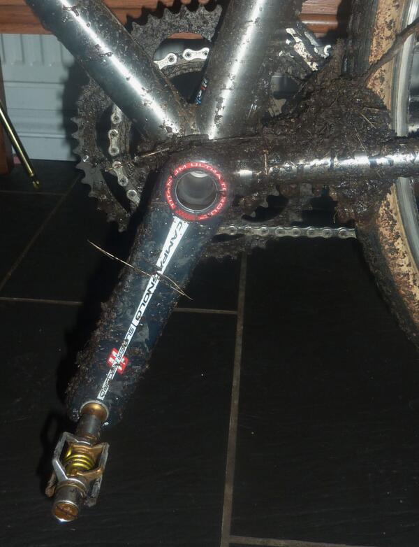

I ran a full campagnolo set-up for cross the last few seasons, it didnt cope well. One mud and gravel track destroyed a mech, one grassy and muddy track took another, cassettes clog up a bit too. I think next time would be the set-up as i run on my commuter above, that way can use MTB mechs and cassettes for mud survive-ability and campy shifters cos they are much nicer than anything else (IMO).
