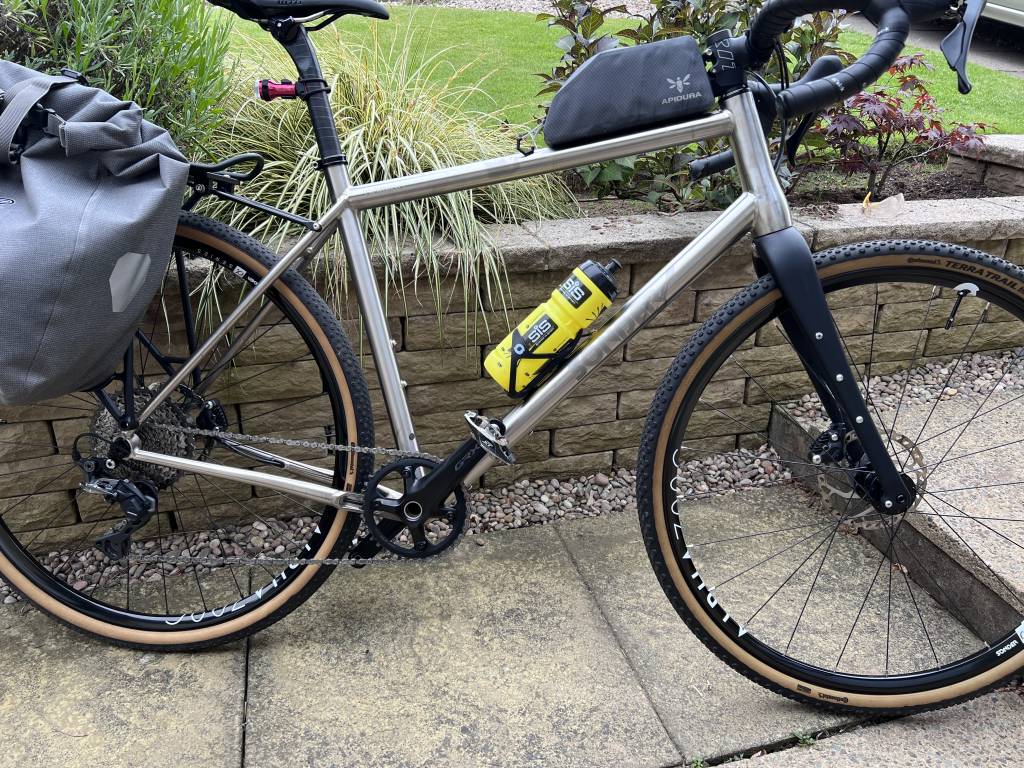

I’m 5’10” and have a large Camino. There’s no way I’d be able to fit a 170mm dropper. I have 32” inside leg.
I wish I’d gone medium though. I find the stretch on the large too much despite fitting a shorter stem. However a long term back injury isn’t helping that. It’s definitely more of a stretch than my road bike.
The only pic I could find
IMG_2920
