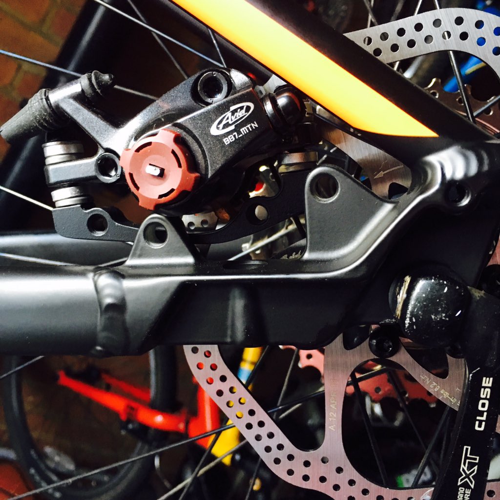

The Boy and I started building his new bike at the weekend, based on a 14" Cube Attention SL frame from Bike-Discount. Hit a bit of a problem when we came to fit the brakes, though: BB7s are a complete non-starter (see below) as there's barely any space inside the stays.
According to the spec sheet the complete bike came with M315 calipers. So they're the obvious option, I guess. They're cheap enough, reach-adjustable, and it looks like they use the same pads as my Spyres, which is a bonus.
Anyone know from experience whether anything else will fit a 14" Cube? Or whether anything else has identical dimensions to the M315? Needs to have adjustable reach, as The Boy is only 9. I'm totally out of touch with hydro discs as I've (nearly) always used BB7s.

Just built up the same frame from the same supplier for my eldest by transferring all the bits off my Inbred.  So I can reliably say that an ancient XT Calliper (Couldn’t attempt to say which version but at least 14 years old) fits fine (As do the 26” wheels).

Shimano slx fit fine so I would imagine most shimano calipers will fit. The hanger is direct mount so don't forget to remove the b link from the mech or you'll have a weird mech position.
Posted : 03/09/2018 10:59 am
It might be the adapters .... if you just sit the caliper over the rotor (loose) will it fit?
I couldn't fit a 203 rear using the shimano adapter but a £2.50 "lifeline" one worked ...

It might be the adapters …. if you just sit the caliper over the rotor (loose) will it fit?
Good thinking, but sadly no, no room. Though I did notice that in the image above I'd used the +0 adapter for the front, not the +20 for the rear. Doh.
