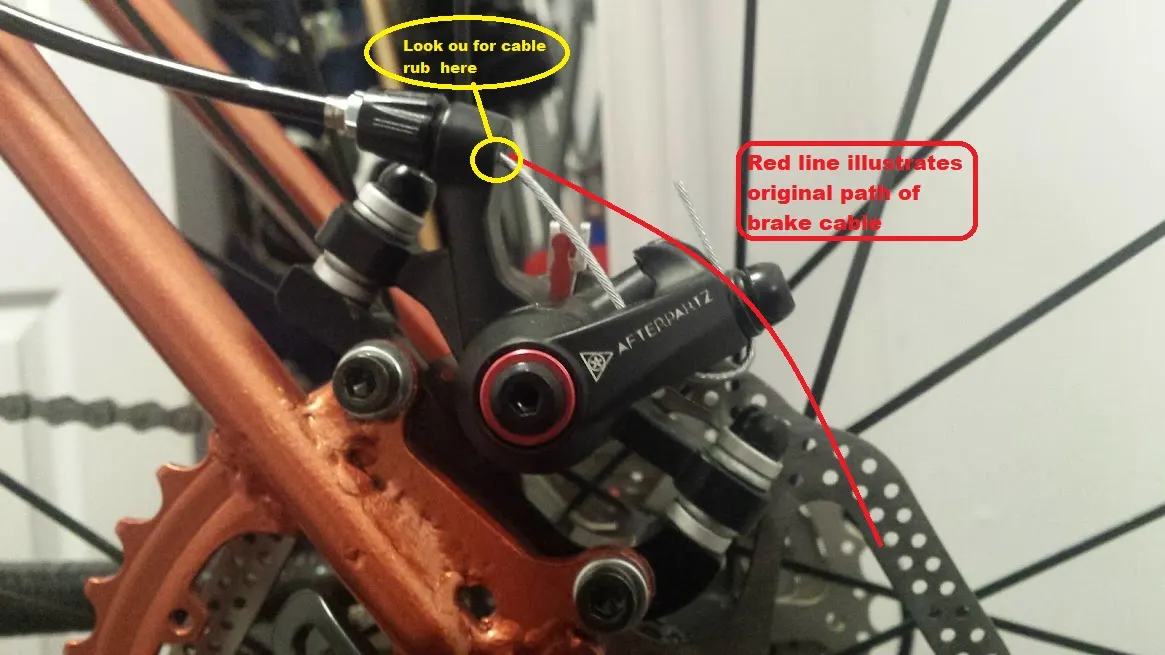

Has anyone tried this? How did they get one? I've seen the below solution on the internet but I'm not sure how safe it is- the cable does seem to be very securely held in it's new postion. It looks like Problem Solvers have stopped making the in line ratio adjusters too, so that's not an option either...
https://skyaboveus.com/cycling/Bicycle-Hack-Use-MTB-Mechanical-Disc-Brakes-With-Road-Brifters

Posts: 9306
death in a cable
Bonkers. What happens to a cable that's repeatedly flexed under high tension over a hard edge?
And who stuck that disc mount on with JB Weld?
Is the blogger still with us? : )
