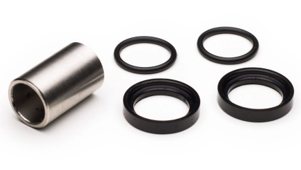

We sell bushing kits for the Meta SX (20-23 bikes) (and all other Meta frames) over at Offset Bushings here - https://www.offsetbushings.com/products/shock-bushings-commencal-meta-2021 .
One neat thing is that from factory Commencal don't use a DU bushing in the rear mount, so our kit adds one in and removes the play the factory setup has.

So, feeling flush, the lad has bought himself a Cane Creek Kitsuma and it looks like I just need one mount hardware/bushing for the front shock mount. Frame supplied with a 10mm bolt, but the shock eyelet is normal diameter, so there's just the one bushing needed in required in there. Looks like @offset [url= https://www.offsetbushings.com/collections/all/products/standard-bushing ]site[/url] has single "standard" bushings, so I guess I order that with the frame/shock specified?

Sure, just note you need the front 20x10mm when ordering this https://www.offsetbushings.com/products/standard-bushing
Apologies, the flip chip at the back that’s specific to the SX appears to be a 10-12.7mm diameter stepped bolt inserted into a DU bush. Good to see they resolved the issue from other frames!

Posts: 6884
Gawd, the Commencal site shows spacers/o-rings with the bushing. Do I need those? I hope this damn bike is worth all the stress!

Posts: 6884
those, I mean :
https://www.commencal-store.co.uk/ride-alpha-hardware-20-x-10-c2x19999500

Posts: 538
They should come with the bushing
Posted : 29/03/2023 1:24 pm

Thank gg - yeah, seen a vid on youtube now, definitely needed 🙂

It’s all good, just different styles of kit that all work in the same way. The product I linked to above is what you need - we produce lots of these for the Meta. Ours use full width spacers rather than an O-ring setup.
Hope that helps,
