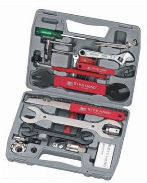

if you do decide you want a cheap set:
[url= http://www.wheelies.co.uk/p50649/Bike-Hand-Bikeland-19-Piece-Tool-Kit.aspx ]clicky for £25 tool set[/url]

There's good tool kits and bad ones. The Bike Hand one is excellent at the price, CRC's X-tools line are higher quality, Superstar do a good one too (I don't like the interchangable handles thing but it's quite sensible). Buying individual tools soon adds up. Course, some toolkits have relatively few useful tools, padded out with low quality non-bike tools, internal BB tools and the like.
