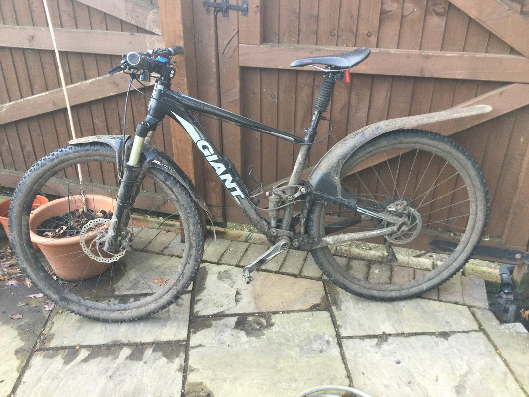

I bought this bike secondhand and shortly after the official bearing puller kit. New bearings cost £30 and have done 2 winters and are still sound.
£30 for at least 3 winters of comfort. Bargain.
I’ve taped up the area below the rear mudguard ,so that keeps the linkage mud free. My back gets a couple of dots of mud and my boots get dirty. Apart from that I’m always clean.
Of course, Bonty Muds are fitted.
I love this bike.
Bike
