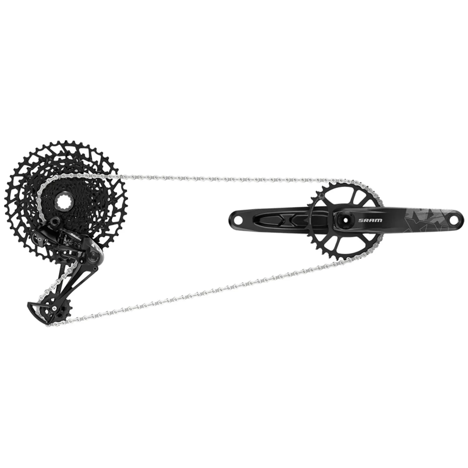

Posts: 3002
Sram NX or SX. Just buy the whole lot, it comes in one box, it'll all work together flawlessly, you dont need to change your freehub, and you get new cranks to boot.
SX is about £200, NX £240ish, all over the usual places.

Posts: 3002
ETA - if you want SLX quality/weight you need to go with GX, which means a freehub change (although this is exaclty what I would reccomend doing, its worth it).

Posts: 5222
NX cassette is fine but go GX/Deore or better for the rest. NX chain is utter bobbins.

Posts: 3297
Don’t buy SX, it’s atrocious. But NX is perfectly fine (as well as cheap)

I bought a full NX groupset for £210 on the eBay Alpkit store and swapped the mech and shifter for SLX from Merlin and sold the NX mech and shifter for exactly the same money on eBay. Hopefully the best of both groups.

Wow. The thing is you can probably sell the crankset and BB for £100 net if you don't need them. So that's £90 in effect for cassette, mech, shifter and chain. Although I admit the chain needs upgrading to GX as per the comment which is what I did for a net cost of £5.

And while SX is quite poor, NX isn't.

Ive fitted Advent X to 4 bikes over the last year. All running fine with no adjustment and surviving winter riding at the FoD. On the other hand NX lasted one ride and the GX on my ebike needs constant tweaking. Kids Racing have the mech, shifter and cassette for about £113...
