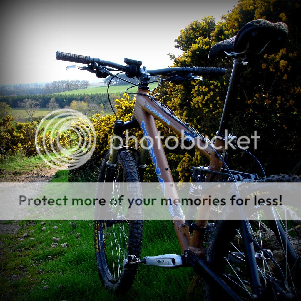

I built mine up proper cheap as a first full susser. Raided my spares, my brother's spares, classifieds and ebay. Think the only new parts were cables and the chain guide bash thing. Now running on different wheels (tubless on bontrager race). Owes me about £300 (I did have a lot of spares!) and it's great fun 🙂

Restless, that looks like a nice bike - what tyre clearance do you get on the back? I quite like the idea of running fatter rubber (I like 2.25 plus for summer).

Clearance at the rear bridge is useless on them, a 2.1 Maxxis advantage or crossmark is the limit really. Unless the later ones got better, mines a 2005 (I don't think they did though)
