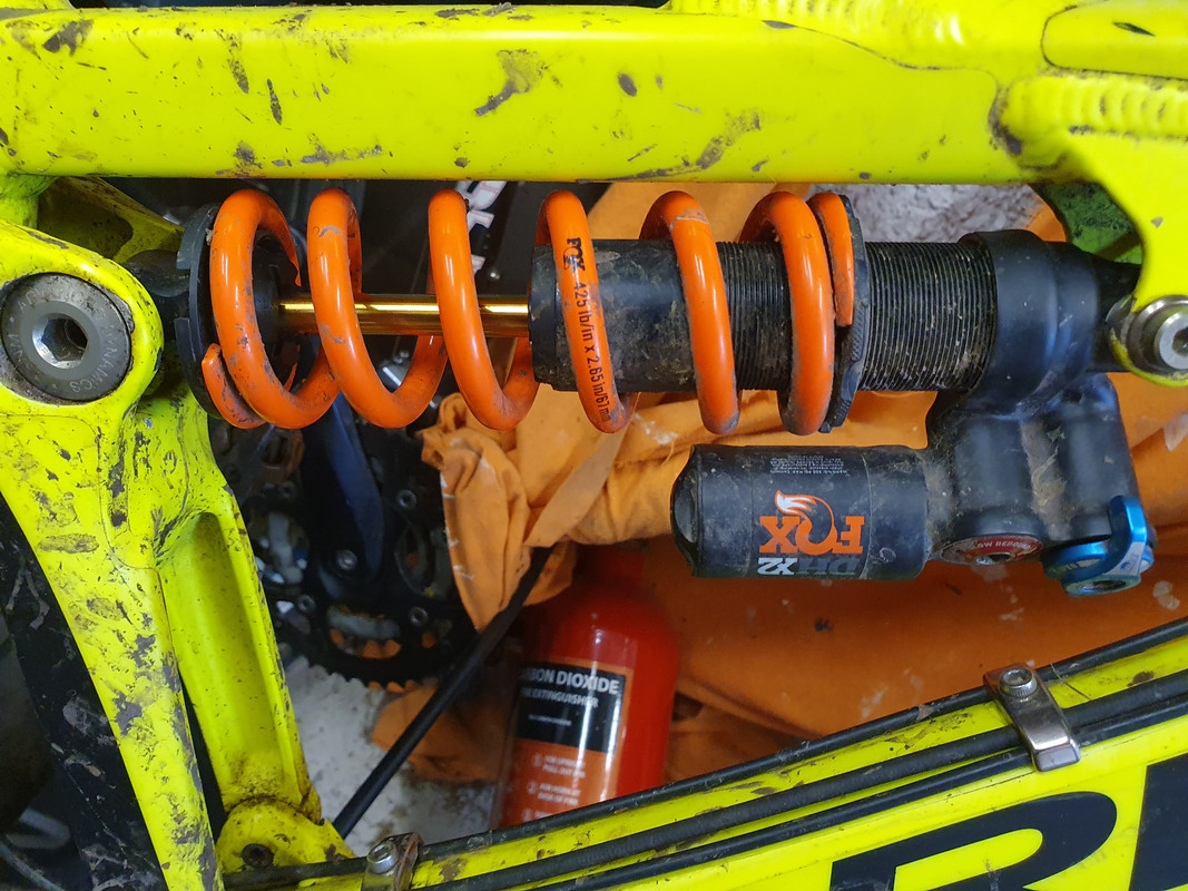

Works fine on my Rallon, maybe try somewhere else if LBS can't or won't get.

I was looking an the air shock but speaking with TF Tuned they’ve said to try a coil.
How do you get on with yours? Assume that clears the frame ok?
