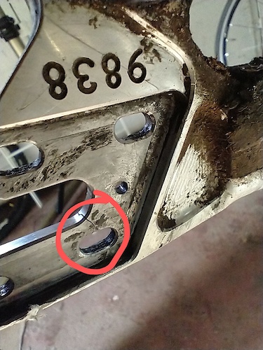

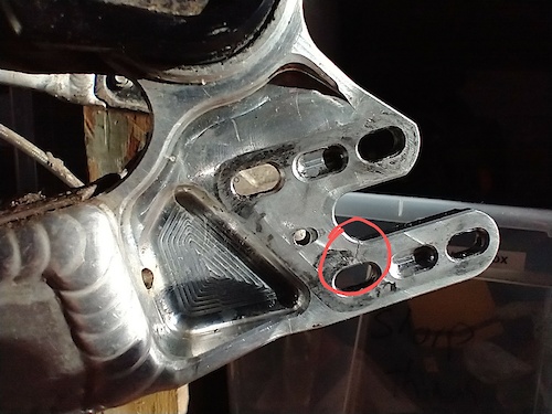

There was a knocking from the bike and I kept putting off looking at it. My bike had an older design where the bolts at the dropouts that held the chain stays to the seat stays went into the chain stay. The knocking was one of these bolts. When I got round to tightening it, the bolt had worn the chain stay. When tightened there was still play. If I just kept riding it it would have got worse.
new drop out
The new drop out have the black bit at the end. This is replaceable so if the same thing happened it would just be the one wee black bit to replace not the whole chain stay.
I stripped some of the bolts holding the drop out plate in place. When a new one turned up the frame has cracked.
I think it's because the drop out has not been tight enough and it's been shuffling about.
It also snapped a bolt in the linkage on the first morning of a week in the bike park. I think that was due to over tightening. It was pricy getting it drilled out and replaced.

🙁 is it just me, or is it visible where the bolt holes have been 'hammered' by the movement of the loose dropout?
If it were me, of be tempted to see if that can be TIGed, as it's plate, not tube.
However, I am not a fabrication person, that may be a silly idea.

On a more serious note, looking at the pictures, given the dropout is held in place by 4 bolts, i'd be more included to take that to a local Alu welder, get it fixed & just ride it & make sure the bolts are tight.

I'd try getting it welded, the interface between the dropout and frame is pretty big so IF everything is kept tight then I would imagine it would hold up.

Getting it welded.
The alloy is not massively thick there. I thought about it. Then I thought about having faith in the frame when doing something daft. Hence new seat stays.
Same for the chain stays. I'm sure I could have had something done to fix them. But I'd rather have it be right.

Well after a load of faffing and buying a new blind bearing puller it's all gone back together.
There were a couple of stuck bearings that exploded. When were they changed? No idea! Any way...
As well as the 4 bolts that hold the dropout on there is a pin that goes through the drop out plate, the frame and drop out. I had to drill the frame in the correct place to get the wheel to line up. That went fine.
I took it out today in the horrible slop. Manky enough that a dog walker looked me up and down and exclaimed "look at the state of you!' this might also explain the state of the bearings.
The bike itself was as great as always. Even better for 3 weeks only riding my hardtail.
Aaaaaaaaaad I'm relaxed and can stop looking for a different frame 🙂

The sealing on the geometrons is very good, additional o-rings on the bearing caps. Would suggest steering clear of any mucoff like cleaners and also the pressure washer.

I'm surprised about the dropout issue - the number of bolts on there has always suggested a lot of redundancy there (and I've never had one of those come loose in many many years riding them).
