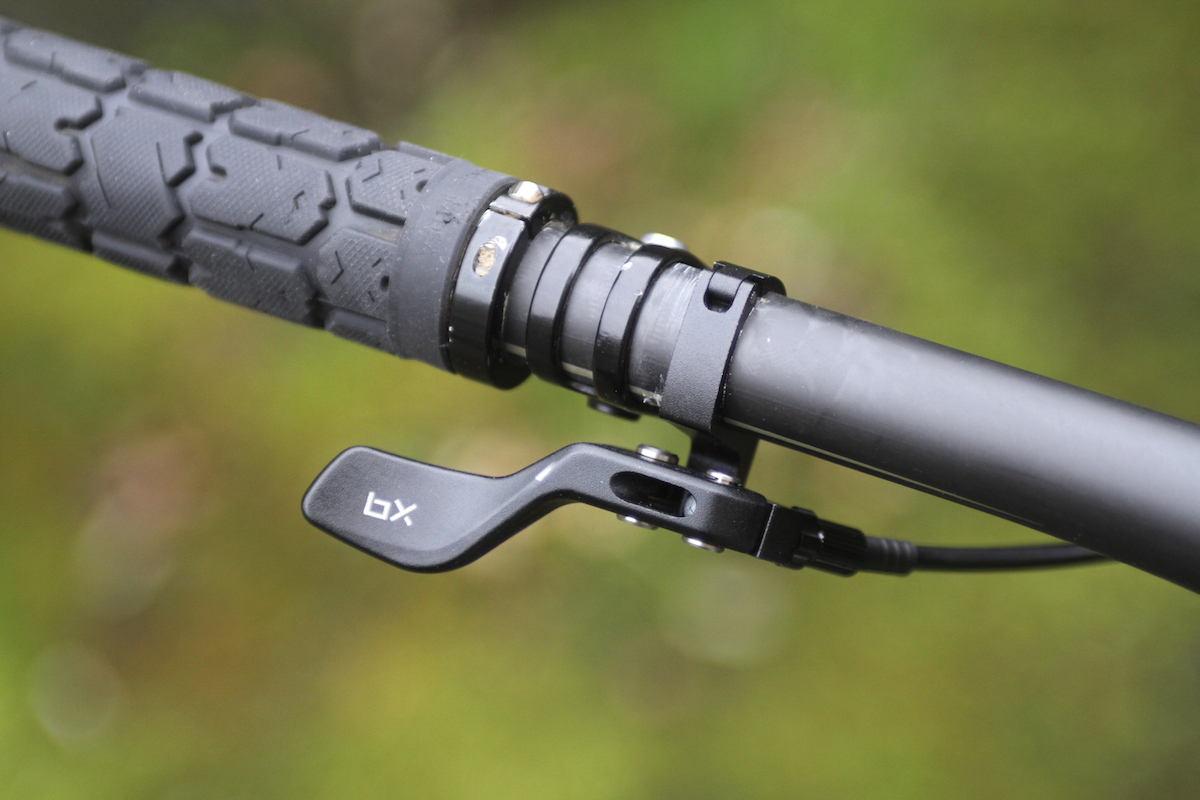

I have the older Brand X dropper where the lever has a single bolt holding the lever to the bar clamp. Loosened it off to remove it from bars to add something inboard and now can't get it to work again . Every time I use the lever the whole assembly swivels round the bolt. There doesn't seem anyway to get the lever to lodge on the clamp so it will actuate the cable. Help please! I have disassembled it quite a few times and still can't see how to make it work

Is it this one?
If so, don't bother trying to repair, they're junk.
Pretty sure the lever part just has a shaped section that fits onto/into the clamp part to stop it rotating.
edit: this is the newer lever but the old one is the same, the flat on the clamp part fits into the flat section on the lever part.
You've either rounded that bit off, or bolted it up on top of the clamp, so it's not sitting "in" the lever recess.

Can you post up photos of both ends of the lever / bolt: I'm curious as to why its not going back together.

Just put the brand X lever back together the right way and it will be just fine .

Finally got the Brand X back together but have ordered a different one. I can't be bothered with the faff every time I need to move controls about
