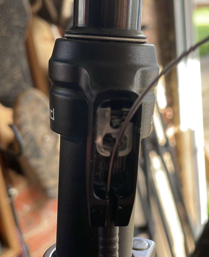

Anyone done it and if so how? Both want the nipple end of the cable. Also would make it tricky to add tension without an inline adjuster.
I’ve looked at 5mm knarps (new word for me) but they all look too big for the gap in the lever. It’s external routing btw.

Thanks, although I think the internal one has more leeway as the cable end drops into a barrel so you can swap it for a knarp thing. The external one the cable drops straight into a recess about 5mm x 6mm max.  I’ll order one and see but I think they’ll be too big.

Don’t know if this helps for scale.6F193F6A-FA0B-465A-BA16-4A3644EDC992

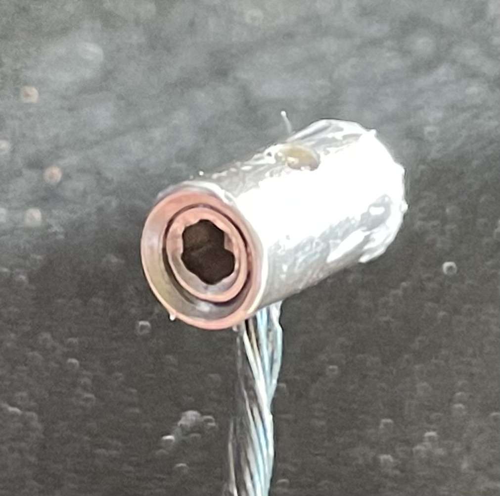

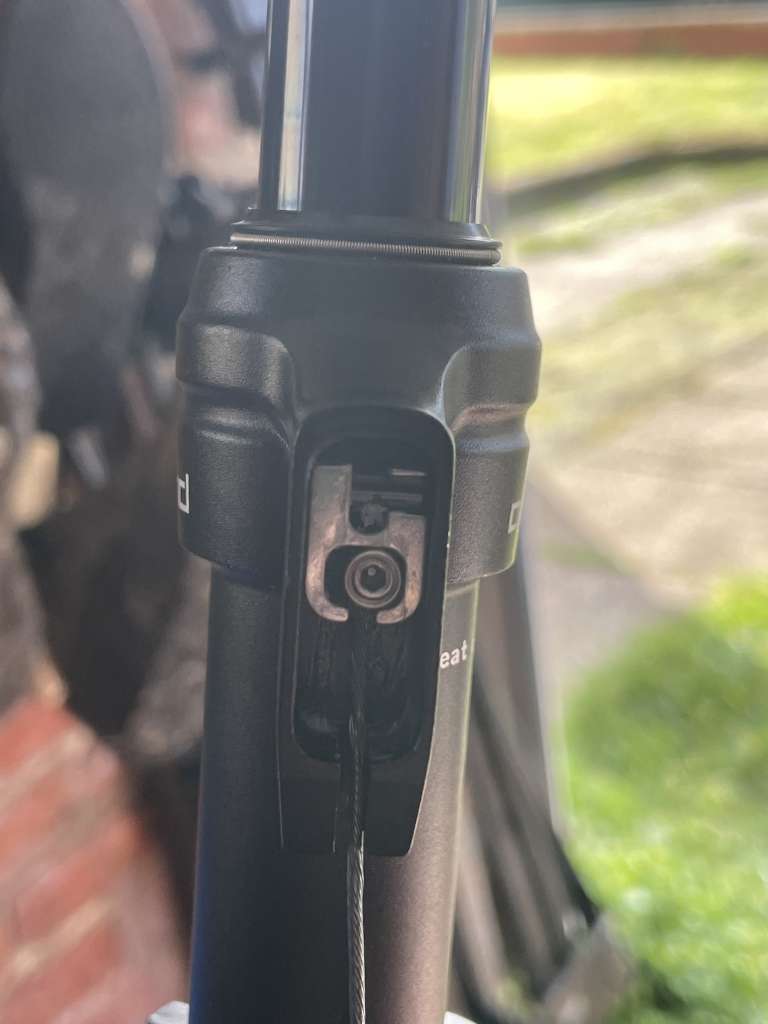

Thanks, I had a revelation today that I have a part that will fit if I rotate it 90 degrees. For unknown reasons I didn’t consider that! Thanks everyone, now I need an inline adjuster.

I have a 5mm cable clamp from an old ks lev post that just fits end first. I’ll grab a picture later, don’t know the part number but it is especially compact one.

IMG_0106IMG_0105
