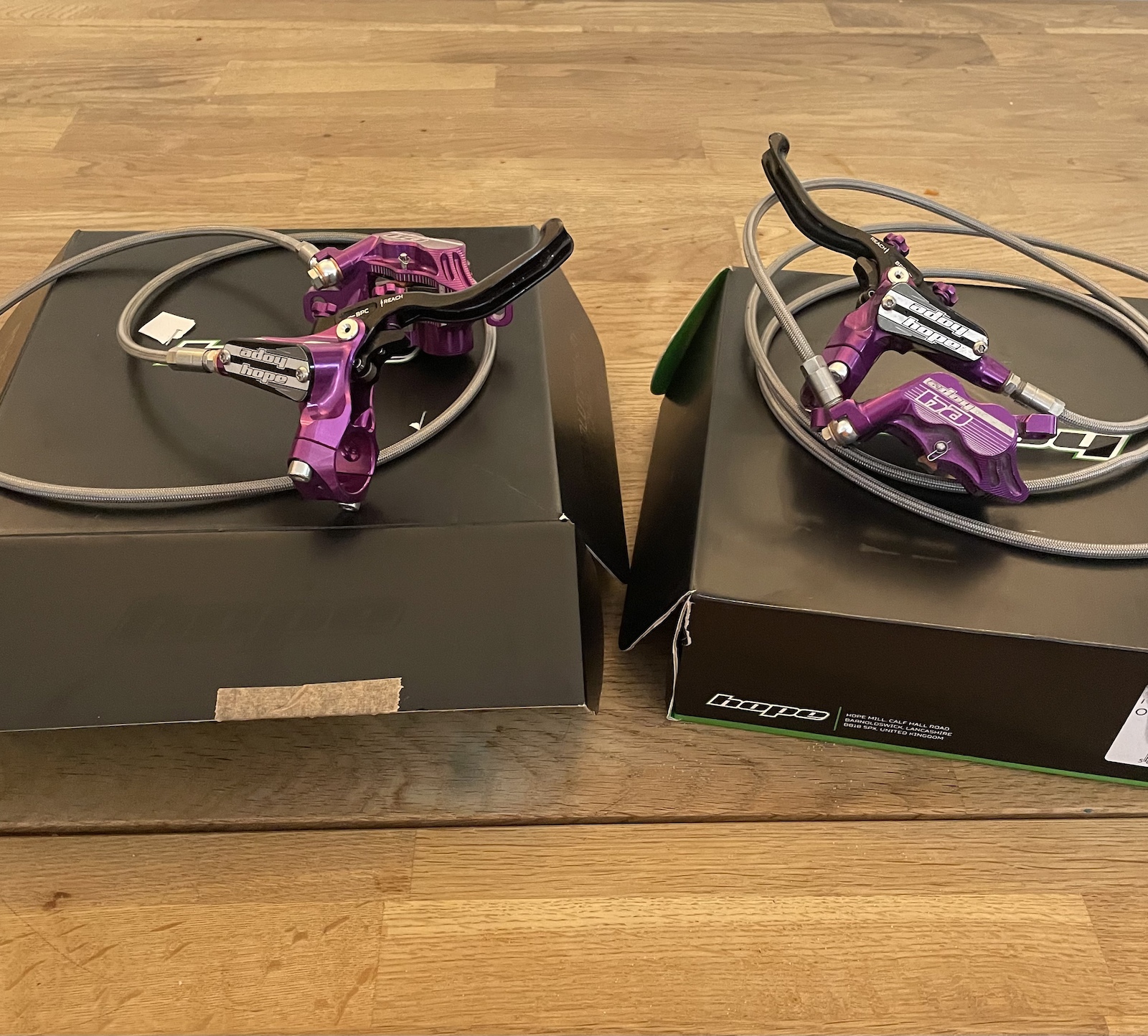

Posts: 9046
I've some new Hope X2 and E4 calipers(in purple) for sale on retrobike - £140 (just the calipers, plus caliper fittings,pads etc)
Ooooooor
I also have a new set of black Tech 3 V4's i was intending to put on the ebike. The front is made up(940mm I think) the rear is just the lever and caliper(plus lever/caliper fittings, pads etc) As the hose needs routing through the frame, i didnt connect it all up. But i could chuck in 2 1/2m of new Hope hose so you can custom size for Jr's bike
Tech3/V4 i think retails about 360, so how does 280 sound. That would inc posted 1st class recorded royal mail.
