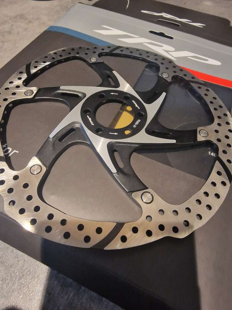

Got x2 trp 2.3mm rotors for a tenner each from merlin but there sold out at the minute

I got some of those Evos last month. Now waiting for my LBS to get me some 2.3mm discs as nowhere has them in stock. They are going to be around £45-50 each for centrelock versions in 180 and 203 diameters. Same price as online but my local shop will knock a bit off that.
Thought I might as well go and set it up as recommended from the beginning. Discs are more than the rest of the brakes!

merlin have the 203 centre locks for £15
https://www.merlincycles.com/trp-r1c-centre-lock-rotor-282010.html

Found some 6 bolt 180 and 203 mm rotors from sprocket cycles if anyone is still searching for those …… on sale at the min too 😊

These rotors are a bit sexy
20231108_130048

What's the benefit? Less dead lever travel?
Aren't they harder to centre though as I assume there is less margin?
Clueless of Sussex
Posted : 12/11/2023 11:35 am
Aren’t they harder to centre though as I assume there is less margin?
The ones I've pictured above are 2.3mm (but not cheap). Haven't noticed any difference setting them up. Your levers/calipers sort themselves out when your first compress them.
If you've been running thinner rotors, you'll probably want to reset your pistons.
Benefits - heat management I think
