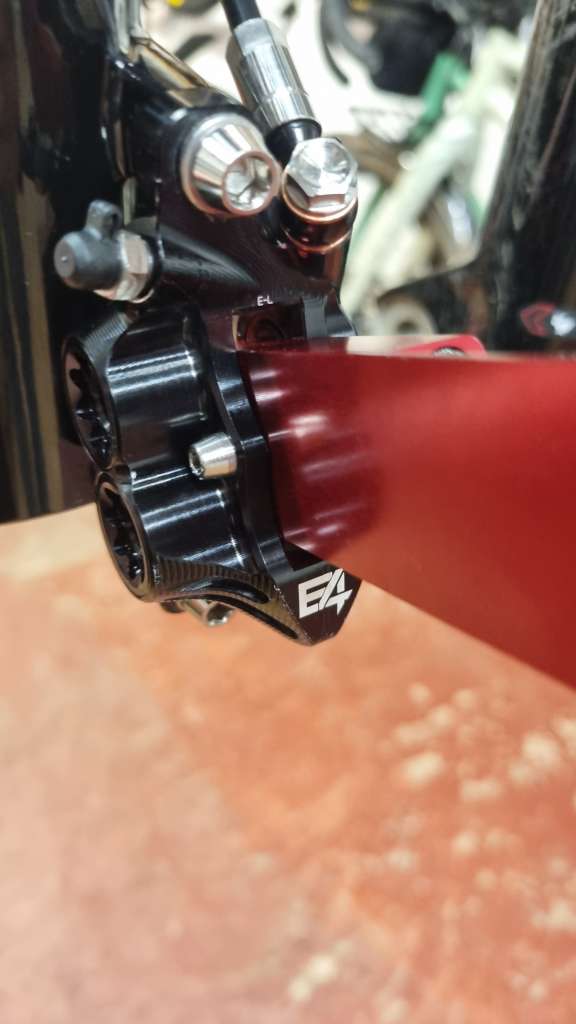

IMG_3092
Posted : 12/12/2024 7:54 pm

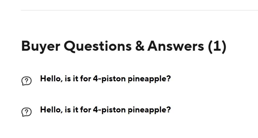

I went right through to checkout with one of those Sumart tools (clicking the link for STW goodness) but then pulled out as it’s a lot of money (for me), if I was still working as a bike mechanic I would buy one, however, now I’ve got time to work more slowly and only on my own bikes I’ll stick with the Shimano tool I have. I’m not saying that I will never buy one, it’s a desirable tool in my “cheer myself up” wish list!
Posted : 14/12/2024 10:23 am

So my Sram brake spreader tool arrived... And it's flippin' ace!!
TBF, I was a bit disappointed when it arrived; the threaded lead-screw wasn't very smooth to wind in or out. I pulled it apart, cleaned the threads and applied a very light coat of lube. That transformed it.
I've used it on Sram 2-pot and 4-pot brakes, and also on the latest Hope 4-pots (Tech 4 / E4). It's worked beautifully on all of them.
Thanks to @oceanskipper for putting me right, I'm now removing the old pads, pumping the pistons out a bit, a quick clean with IPA before diving in with the new tool. The tool makes pushing the pistons back an absolute doddle. Even easier if you give the lever the occasional light squeeze.
No more fannying about with screwdrivers or tyre levers 🙂

Posts: 13741
I really want to know if that  Aliexpress one is for a 4 piston pineapple
Screenshot 2025-01-05 120212
That one you bought it does it spread the piston by pushing down from the top like pushing a wedge in?
Where as something like this https://www.aliexpress.com/item/1005005610286620.html? pushes them back square in rather than top down
