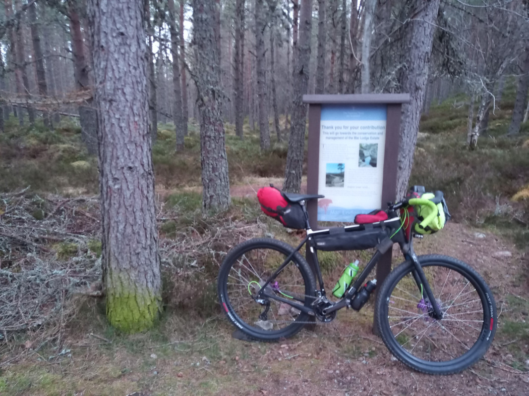

Downtube bottle made it nicely to red house and then corrour and back down via Derry lodge.
No bottles were hit lost nor covered in mud. - the spray seems to get my feet more than anything.
