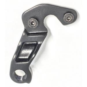

Looking at a picture of the hanger, it looks like it forms the inner face of the dropout?
Fitting the wheel without the hanger means that (a) you've had to flex the stays inwards when you clamped the wheel and (b) probably something on the frame is now fouling the hub or cassette.
I wonder if you're clamping against the cassette lockring or fouling the 11T ring, which would explain why you can roll the bike forwards (freewheel allows cassette to stay still) but not backwards (cassette would then have to rotate).
Anyway... you need a new hanger installed and hopefully it should be okay.

Fitting the wheel without the hanger means that (a) you’ve had to flex the stays inwards when you clamped the wheel and (b) probably something on the frame is now fouling the hub or cassette.
I'm at work so cant check but when I read this, I was like doh, of course.
Thank you very much.
