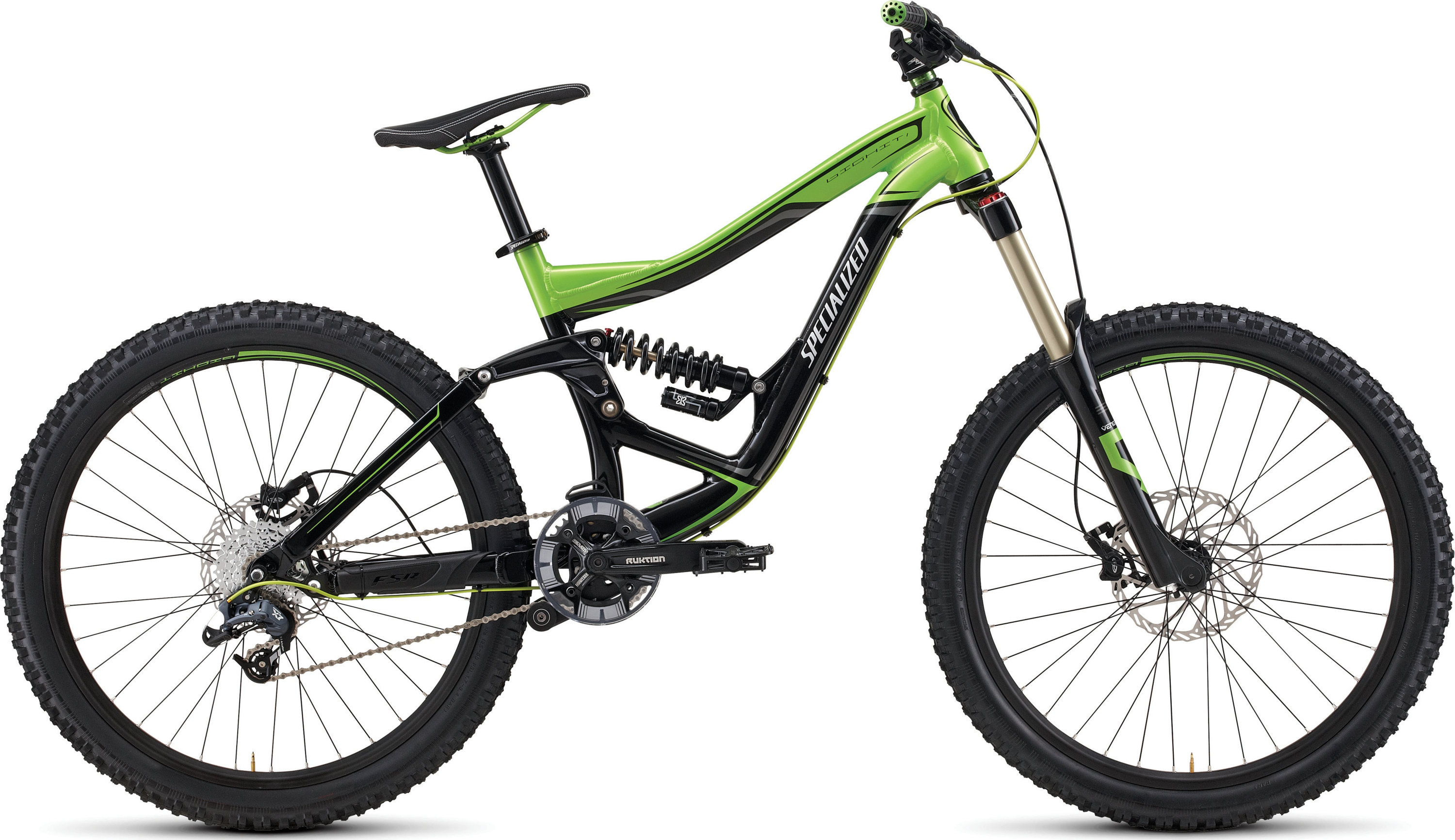

I've just noticed how alike these frames are:

No point, I just realised that the curvy down tube seems to be the current vogue among the DH frame designers, although I can't imagine it's the lightest and strongest solution (although I may be wrong).

for many years all mtbs looked like this
id like to think that dh frame design has simultaneously and independently evolved to such similar lines because they are the best way to achieve strength, rigidty, light weight, standover, geometry etc
maybe thats partly true but i think its also because everyones just copying everyone else

Take a look at the Transition and Nukeproof in particular. How would you get the shock that low with a straight downtube? It's all about lowering the centre of gravity right now.

why does the nukeproof have such a steep seat angle?
it's different from all the others due to this.
Posted : 22/07/2011 10:03 pm
four or five (is the transition a single pivot with linkage? can't tell from picture) different back end/linkage biznesses going on in those 'similar to look at' frames too.

Superficially similar, because there are only so many places you can put the shock. The devil is in the details.
So the back wheel doesn't bang into the seat tube, and so that the swing link pivot is supported by the seat tube.
Saddle is in a kind of similar place, but it's not swept forward/back like other bikes. Pagey wanted it a bit more kicked back too, but I never got it sorted.
Seat angle is really the angle from the BB to the middle of the saddle. Clearly some of those bikes take a convoluted route to get there, though I think you'll find the angle is pretty similar. The Nukeproof has a 72deg seat angle.

Sure, they all look similar, but look in detail they're all different. Suspension pivot locations are ALL in different places.
Therefore they'll all be totally different to ride.

Every one of those frames requires a bendy DT for shock clearance although some are a little more accentuated than others. None of them are out of a catalogue although some use stock tubes. If you look at them up close you'll see they are all very different in terms on engineering design. As retro says, devil is in the details.
