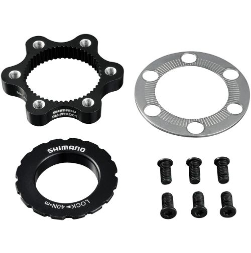

Posts: 3879
Just a longer one of these, shirley?
[img] http://chainreactioncycles.scene7.com/is/image/ChainReactionCycles/prod130953_IMGSET?wid=500&hei=505 [/img]
Posted : 01/12/2017 10:15 pm
Posts: 3224
yep, dowels id think.
The screws in the shimano ones.. don't they screw through from the back...i.e create the same effect as a dowel rather than the bolt heads holding the rotor to the adapter. as greyspoke says, you cant have lock ring and bolts. And as presumably pauls components found out, you cant do away with the lock ring either as this, combined with a 6mm ISO spacer would have solved the problem already
6mm longer splined CL adapter and 6mm longer threads on lock ring has to be the solution, probably not cost effective to produce in small batches though.
{edit] just wrapped my head aroudn the bolts retaining the rotor and the silver plate spacing the lock ring above the bolts.
6of1 1/2doz the other i guess
Posted : 01/12/2017 11:12 pm
Posts: 2514
Yes that's how the Shimano one works I think. Need special bolts though, so not how the NOW8 one would work as no bolts supplied with it. I have a dowel type DT adapter (I only use the lockring, not the adapter) and I have to say it does not inspire me with confidence, there is rotational play in the disc when you fit it and I reckon it would wear the dowels. The Shimano approach looks less shonky and I would trust them not to come out with a solution unless they thought it was bulletproof. Clearly they don't think the dowel solution is, otherwise they would go that lighter ?cheaper route.
