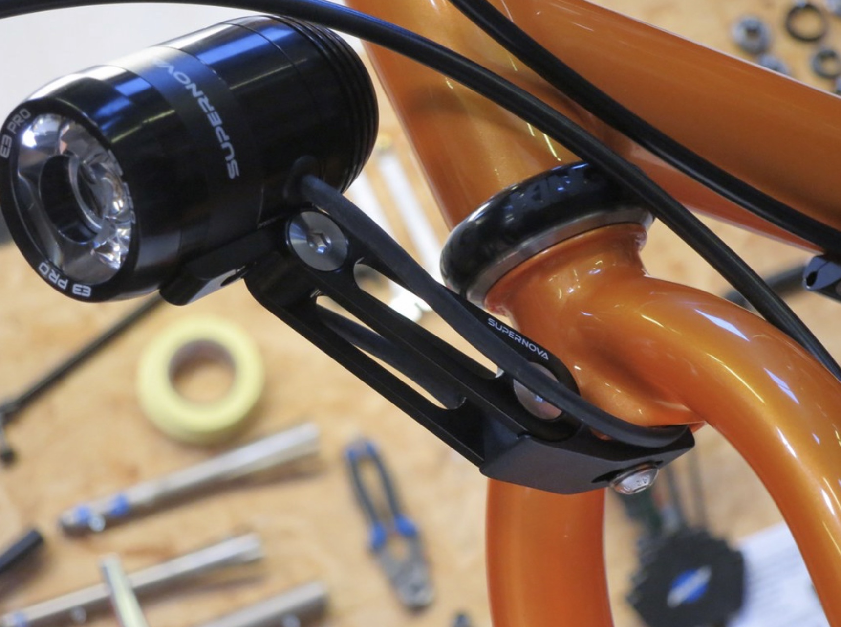

I want to get a 'utility' fork for my gravel bike. The Bombtrack fits all the criteria. Bombtrack have confirmed the M5 bolt hole under the crown is capable of carrying the weight of a dynamo light. However, I need to find some sort of fitment/holder for the light. I've scoured SJS Cycles and can't find anything.
Anyone have any ideas as to what may work?

Supernova mount bracket:

So it's the fender mounting you're going to use? I guess a narrow L-bracket as per Rat above, and then screw the Edelux's own mount on the vertical part.
If you're ready to DIY a bit more, you could screw 2 cm long bit of 31.8 mm tubing on one of the side cage mounts and attach a handlebar mount there. Light would be fairly low, but no problems clearing bags.

^^ looks spot on assuming the bags/light fit.

Can you not flip the bracket you have round so that it fits to the underside of the fork crown?

Since that's my thread linked above I'll say that I ended up putting a plastic gutter down pipe mount on the bottom of the head tube just above the bottom bearing cup. It's a 44mm head tube and I think the pipe mount was for a 40mm pipe and cost about £1. It's not pretty but works fine. The beam obviously turns differently from how it would if it was bar mounted, more like a motorbike.
