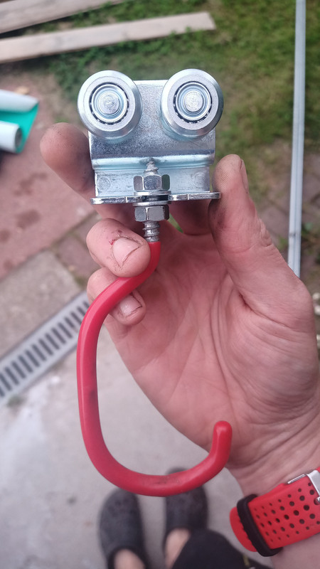

I've just fitted these into 3 m of monorail track screwed to the roof.
Let's the bikes condense for storage and then slide out the way for removing the one I want. Lets me get 3 bikes into the space for 2 when I top and tail them

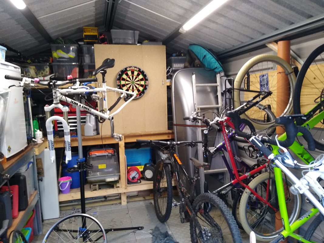

I've got 7 bikes in what was previously a 4 bike space. Yes I have to slide them to the side to get them out but it's like closing curtains Vs the other options
I have videos but puttng them on here is near impossible without YouTube
Meanwhile....worst photo ever courtesy of casiocalculatorpotatocam

The rather prosaicly named
Rollingcentre.co.uk they hide undersliding door parts
Roller carriages were 7.40 and the galv monorail 27 quid.
Be warned the monorail is tough good drill bits required.

Posted : 21/06/2021 4:53 pm
Thanks for suggestions, the roof box unfortunately can’t go any higher due to the roof and that weird remaining window.
I did contemplate moving it beneath the units but it would be a Herculean task to manoeuvre it past the car to the other car outside.
Think we’ll run with it on that little stand for now and see how it goes - to your point it means the bairn’s bike can slot between them on the floor.
I did a quick test with my Cycleops riser block which would mean sufficient height clearance but the width of the nobbly tyres lift the block up lol

Sorry can't seem to edit the post above, I've ordered one of the Steadyrack MTB holders. I reckon that'll get me around the handlebar height/roofbox issue.
Posted : 22/06/2021 12:37 pm
Posts: 1131
Can't you hang the roof box from the ceiling above your car to free up that whole wall?
Posted : 22/06/2021 12:52 pm
I've not got the head-height unfortunately mate. The original garage was converted into a fourth bedroom (or prison for his mother in law, I'm not sure which). So the pentagonal one was created (also by previous owner) to fill the void.
The ceiling is covered in some form of foil insulation and there are non-structural wooden battons visible - I assume there are joists behind there but can't see them.
I'd also be petrified of the roofbox faling out and crushing the soft-top car that lives in there. I think this Steadyrack will solve the issue, unless I ever get the n+1 itch 🙂
Posted : 22/06/2021 5:08 pm

@trail_rat the carriages are here https://www.rollingcenter.co.uk/products/rolling-center-4-rc-4-wheeled-carriage-with-bracket-stainless-steel
But I cannot find the rail of the right size, 25mm wheel centres?
Posted : 28/06/2021 8:57 pm
Posts: 39347
For those carridges it's 80 z or g you need
Go onto the monorail page and the spec sheets at the bottom listing compatibility those carridges are 4rc units.

With massive thanks to trailrat for the idea I spent this afternoon drilling the steel monorail I bought from rollingcenter and then installed it in the bike shed. The roller trolleys worked easily with B&Q hooks as trailrat suggested and I then bought 2 larger hooks from toolstation for MTB wheels which wouldn't fit on the smaller red hooks. These required grinding the thread down and tapping an M10 thread (red hooks worked fine with m8 nuts and no grinding or tapping).
End result :
Insta linky
