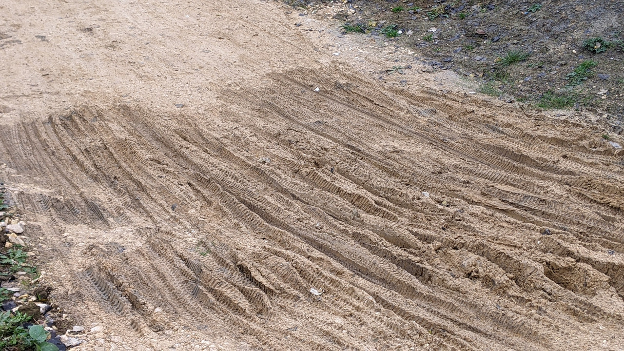

In answer to my own question, not durable enough seemingly. 😐
Popped down to Northampton bike park today to have a razz. To be fair to it, its had a huge amount of use and the weather hasn't been great, but yeah, I was pretty disappointed in just how knackered parts of the track were really. It hasn't really held up that well unfortunately.
Thought it would be more hardpack and able to withstand the weather and traffic a bit better.
Most of the deep, muddy rutted sections are coming into or out of jumps so things get pretty sketchy.
You can see the section in the below image, in the landing of the biggest jump in the above image.

Is it just a few places or enough to spoil a lot of the riding? I'm pretty close and have been meaning to visit but might be best to wait until spring
Posted : 04/12/2022 3:12 pm
It's quite a few places. One of the black trails is closed off, presumably because of this.
Might be worth a visit if you're fairly close. Wouldn't want to put you off. It's certainly a great facility. I'm just quite surprised about how worn out it is so quickly.

@kayak23 I had a wander round Newbold on Thursday on my way back from a bit of Wildlife Trust work at Leam Valley. It looks a lot more extensive than I was expecting, and my first thought was 'I really hope they've kept some budget back for maintenance'.
With regard to your pics of the state of the Northampton trail, I don't think you'd get it muddying up like that unless you had standing water - as someone said above, it's all down to water management. So it's a profiling issue rather than a surfacing one, although that profile issue might be caused by the erosive effect of the landing zone.

Yeah I agree.
I mean drainage though is on the first page of the trail builders book so it's surprising that it's a problem when you'd think that, that would be forefront in the way that any trail is built by a specialist company.
It's basically one of the first considerations for building trails in the UK.
Or do they tend to build it and see what happens?
It worries me a bit as it took such a lot of fight to get this built in Leam and it would be a shame to give the enthusiastically opposed dog operators any ammunition to point out that it shouldn't have been done.
Hate to be a bit negative about such positive things for our communities but it kind of feels like having something that's a mess will be worse than when we had nothing.
It's taken a lot to get things like these built so they really need to stand up to usage. 😐

There's always some bit of a trail that doesn't work first time round. Hopefully the land managers have got a maintenance contract in place with the builders to come and snag stuff like that.
Its easy enough to say "always think drainage", but a) unless you spend a loooong time assessing the site over multiple seasons first, you can't actually do more than guess; b) the act of building changes stuff anyway as you disturb the ground.
Equally, it might be less well compacted than planned, the original ground underneath may be collapsing, there might be materials issues - we had problems at Lady Cannings - all built using found material on site, but a couple of patches had a much higher clay content than the rest so turned awful in winter.
The steeper the site, the easier drainage is as the water always wants to go downhill. That looks quite flat, so its going to be much easier for water to pool and much harder to get rid of it.

I think what you're seeing there is basically "build it then fix it"- if 95% of the trail holds together and 5% needs fixed, that's still a pretty good ratio and probably better than putting twice as much work into the whole trail in the first place to try and achieve 100%.
This way, they can come back in, reshape and resurface those rapidly worn bits to be much stronger, fix unexpected wear spots or drainage, etc. It looks bad but it's an efficient way to build. Basically you can build a ton more trail on the "build then fix" approach than you can with the "build it all super strong" approach that we've traditionally used.

hi everyone,
I work at the new Bike Park in Northampton and I would just like to add a few things. (sorry its a bit long winded)
The park was built in the hottest and driest summer on record and as many of you know, water is needed to bed in and settle the trails. With the absence of any rain during the build, the builders had to make best guess with regards to water run off, which for the most part they did very well. There are however soft spots on Blue Nunn, A45, Jett Black and Cherry bomb, these are being addressed now with all 4 trails having extensive repairs to build back up the berms that had collapsed and to sort out the soft spots. This work is currently ongoing at the time of writing as the cold spell has delayed the completion.
The park has been a phenomenal success with literally thousands of visits since we opened about 12 weeks ago. We have been a victim of our own success with the West Trails taking a beating with the very high traffic, this has resulted with issues in places on some of the trails as detailed above. We do have a contract with the builders to fix any defects and we also have a volunteer trail crew who will fix minor repairs as they appear, which is happening now.
There is also the need to manage expectation. I have had complaints about, puddles, mud, slippy surfaces, braking bumps etc. This is an outdoor MTB park on a hill in winter!! This is not an indoor BMX track. Defects and anything that is deemed dangerous will be dealt with but puddles and mud will not!!
As I have said the park is only 12 weeks old, it is still bedding in and will not be properly done for 12 months, we are learning about where the "hot spots" are and will address them when needed. The park is managed by local charity Northamptonshire Sport and fully funded by a percentage of the car parking revenue. There are also 2 part time Bike Park Officers who look after the day to day of the park. We have just received our hand tools and are expecting our mechanical tools soon, so the park will get the TLC that it deserves.
To answer the OP question, the surface is very durable but not indestructible, even tarmac cracks eventually. But with regular inspections and maintenance it should last a fair while.
We update our website daily with trial information. https://northamptonbikepark.org/plan-your-visit/__trashed/
Can I also just say thanks to everyone that has come down, I have spoken to loads of people and I am always willing to have a chat, take some feedback, give advice, even give you a tour if you wish. Just look for the guy with a beard and wearing a Hi-Vis.
Happy Trails everyone
Posted : 14/12/2022 7:54 pm

Thanks for your input Paul, great to know it's in safe hands... it's just a shame that the bigwigs at On Track have yet to invest in a bowser to ensure a consistent and professional product; it's a bit odd that trail builders everywhere know the necessity of water in binding trails, yet somehow, despite huge amounts of time, effort, skill, resources and investment (often into the hundreds of thousands) in importing, distributing and shaping materials, somehow, the 'professional' trailbuilders sidestep this requirement, repeatedly leaving clients with an unsatisfactory product.
This is no slight on the skills of the trailbuilders at On Track... the staff are some of the best digger drivers in the business, but choices made by management often hamper the quality of the end product and with it, company morale.
With a bit of luck, this will get the ball rolling and get things 'Back on Track'
Posted : 18/12/2022 9:43 pm
They did have a bowser that they hired I believe, but as the temperature was hitting 40 degrees the impact and effectiveness was negligible.
Posted : 21/12/2022 11:28 am
Well, hiring a bowser is certainly a step in the right direction; given the hundreds of thousands of pounds that these jobs with a maintenance contract tend to cost, perhaps On Track could stretch to buying one, which would help acquaint the team with using them as a routine procedure, rather than a rare and unfamiliar novelty.
That said, today I rode one of the many trails I worked on before the controversial rebrand...
And to be fair, it's a credit to the talented trail builders who are the heart and soul of On Track and has held up well to an onslaught of skidding, schralping and general hoofage; that said, the lad who deserves the majority of credit for the wonder of that trail went to the trouble of buying his own digger to circumvent On Track management and all the guff that goes with it.
Overall, I'm sure it'll come good in the end; the trailbuilders are generally highly talented at bringing their visions to life and are key to the majority of the creativity that combined with a healthy dose of 2 wheels, tickles your fun buttons
There is little reason to doubt the overall quality of materials used and with a bit of remedial work, it should be another brilliant facility to help bring MTB to the masses; however, this is certainly not the 1st time that a preventable situation like this has arisen... hopefully, it will provide some valuable experience that can be learnt from.
Posted : 21/12/2022 7:10 pm
