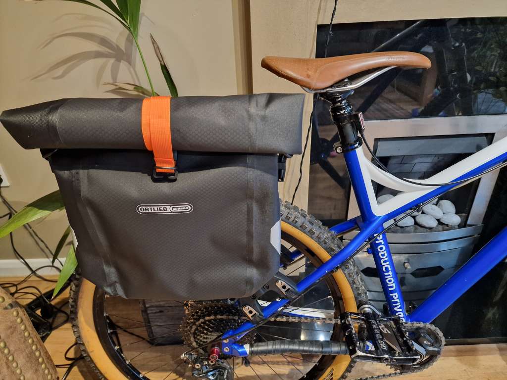

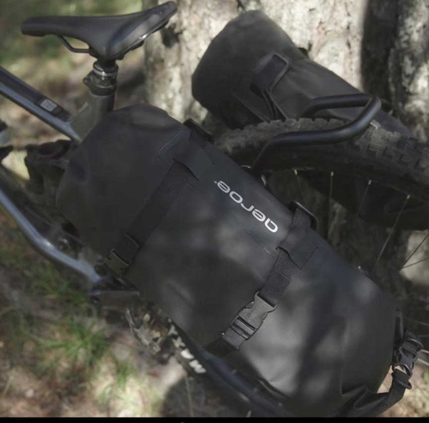

Aeroe Spider pannier rack fitted, along with Stooge Moto bars.
Panniers have arrived but not unpacked as a discrepancy between what I ordered and what has turned up.
Panniers will suit me on a day to day basis more than a big saddle pack - nipping to shops/gym etc. Can still drop the saddle too dependant on how/if I load the top rack.

Can the rack have the main legs removed from the seatstay clamp, trimmed a bit, then refit? It'd get the load lower and closer in to the seat tube, more saddle clearance, it'll handle a bit better plus reduce leverage on the clamps.
Posted : 09/02/2024 1:22 pm
Posts: 5153
Can the rack have the main legs removed from the seatstay clamp, trimmed a bit, then refit? It’d get the load lower and closer in to the seat tube, more saddle clearance, it’ll handle a bit better plus reduce leverage on the clamps.
I’d bet there’d be a chance of interference between legs and panniers though?
Posted : 09/02/2024 1:24 pm
The clamp loosens off to twist to the right angle, so should come off altogether. Looks like the legs may be tapered though

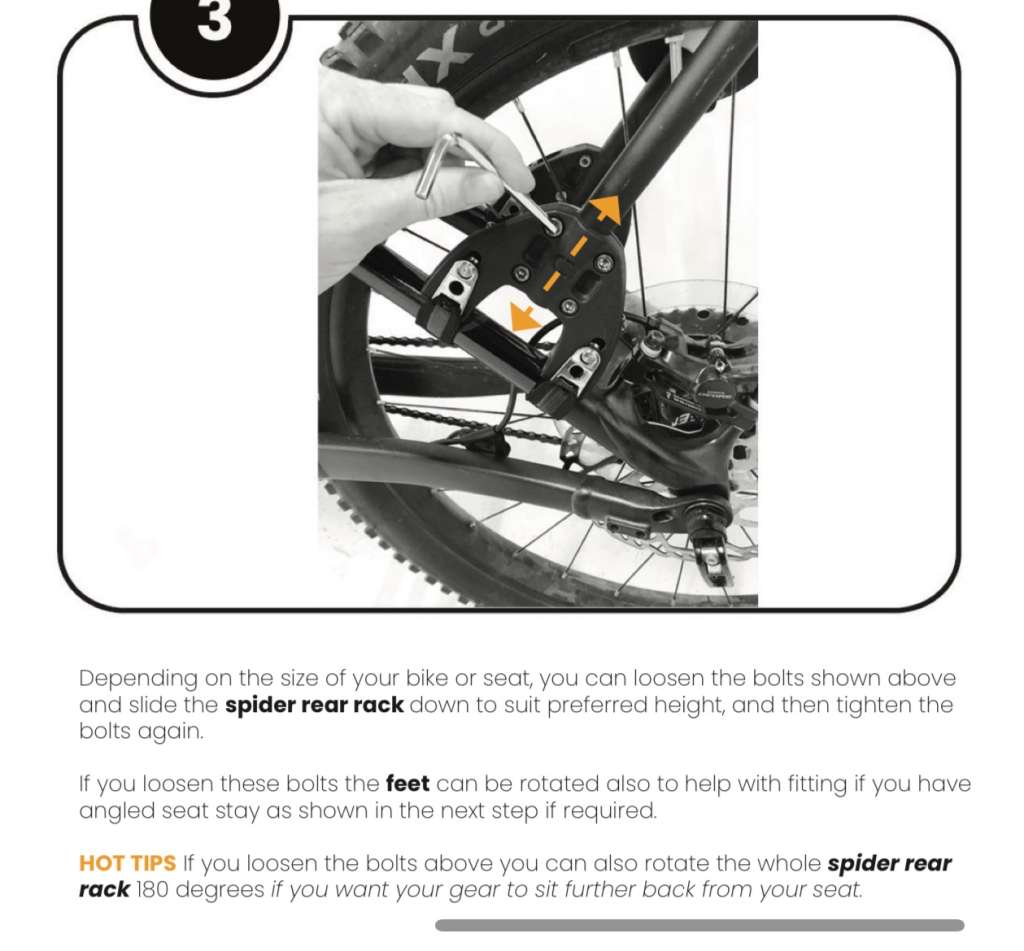

Screenshot_20240209-175037
Posted : 09/02/2024 5:49 pm
Merak and Merak reacted
Posts: 4788
In the manual it’s says legs can be adjusted?
the clamp looks tapered on the outside but the tube is not.
alos means you could trim the tubes down.
IMG_8315
Posted : 09/02/2024 6:10 pm
Yeah we sussed that out up there somewhere ^^ but cheers 😉
I've lowered it an inch already on the adjustment, may trim some more.

Haven't ridden the bike yet with the panniers fitted, but sitting on it and spinning the pedals, my heel is very close to them. I feel shortening the arms will bring them too close.
Anyone want to share their pannier pics and how close they sit to your pedals?

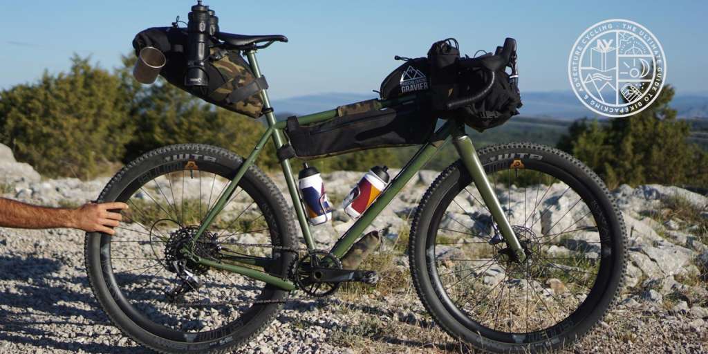

Seems to be a fair bit of talk about how high this rack is - yes, it is a little. I think this may be exxagerated by the small wheels and small panniers (30cm tall), however, I'm not disputing this and appreciate the benefits of having the weight lower.
But then I open the internet and every other bikepacking bike looks like this....
Bikepacking_Bike_Setup_1_bis
Posted : 12/02/2024 8:59 pm
CoG aside, there are good reasons that folk started to adopt those in-line carrying options and one of them was trying to make a rack and panniers fit on a bike that wasn't primarily built to carry them.
TBF, I think your panniers would look smaller if the tops were rolled down and cinched up tightly. I think some folk are assuming that the height they see in the photos is a true reflectionof their size and position.
Also - it's perhaps relevant that the Aeroe marketing mostly shows their cradle/bags fitted at an angle that results in no heel clearance issues.
FWIW I have an Aeroe rack (and cradles). It seems robust, well made and a good solution for when I want to carry a bit more than my normal bikepacking setup.
