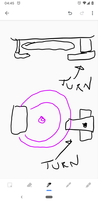

Bear in mind it's quarter to five am and I'm drawing on a phone with a fat finger... 😉
For simple, how about a hook, better yet two hooks (one at 11 o'clock, one at 1 o'clock on the wheel), hook the wheel in flat, then secure the other side with a bungee ball through an eyelet?
Or a simple batten running the whole length of the space with a wider strip of ply screwed to it, spaced off the ceiling enough to slide a wheel into appropriate to your wheels, then another block the other side with a bit of ply with a pivot screw so you can turn it and hold the wheel in?
