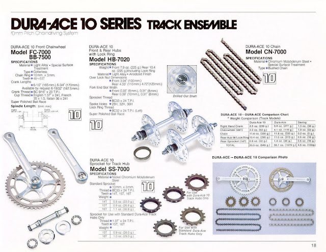

BMX aside we still have the same chain pitch
cassette spacing is boringly regular
control cables come in worryingly few thicknesses
Other than it changing from 8-9-10-11. 😉
Also, Campag use a very slightly different spacing to Shimano/SRAM, just enough to make the shifting incredibly difficult to sort if you happen to be running Shimano gears with a Campag cassette.
Thankfully no-one has decided that chains should be any different, I guess that is one standard that is so ubiquitous worldwide that even trying to introduce anything else would be pointless.
Posted : 20/02/2016 7:33 am
Posts: 3812
Chain pitch? I think that all chains use the same spacing between pins / length of links?
Posted : 20/02/2016 8:14 am

As for chain pitch Shimano did try 10mm pitch for a while...
