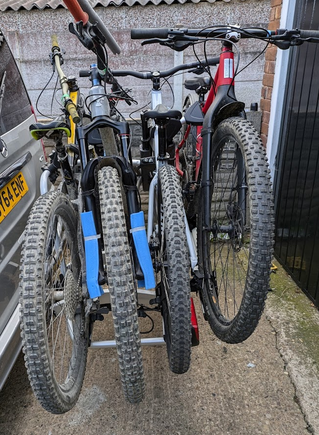

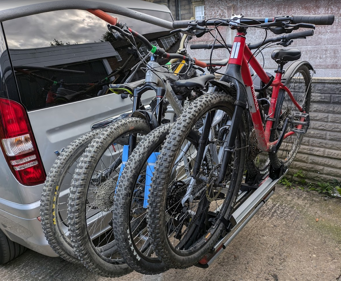

Posts: 10212
My 4 on Atera Strada.
Posted : 20/05/2025 8:41 am
