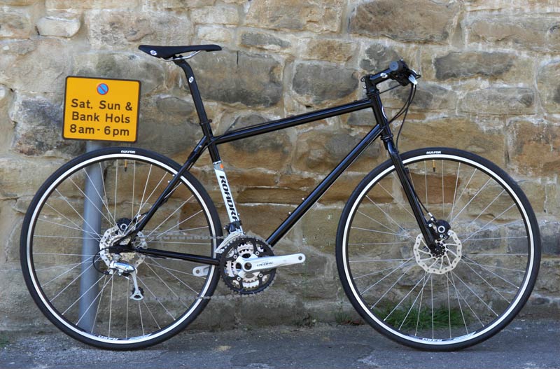

My roadrat (although it now has a front rack as well):
Posted : 29/06/2010 12:13 pm

One thing with the roadrat, is that even with gears fitted you can move the rear wheel backwards for loads of mudguard/tyre/mud clearance in the winter, or tuck the rear wheel in close with skinnier tyres and no guards in the summer.
Posted : 30/06/2010 9:05 am

Thanks for the responses - that gives me a couple more things to look at. The idea of a 26" MTB frame with 700c wheels isn't something that I thought about before, but I'll look into it. Possibly not as much of an option if I'm buying a complete bike on my bike to work scheme though.
Got to admit I'd not considered the horizontal dropouts on the Roadrat being an issue before. I can see minuses and pluses for them though, as people have mentioned above.
Ah, the toe overlap issue: I do tend to find it a problem and if there's a bike option without it, then I'm keen to explore it. I honestly didn't know toe overlap existed until I bought a road bike a few years ago (which I sold soon after...). If it was totally unavoidable then fair enough, I'd just live with it, but my wife's bike doesn't suffer it being a 700c wheeled flatbar Giant and the Roadrat certainly claims not to have it (the flat-bar model): [i]"For flat bars, we didn't want some half baked 'flat bars stuck on a road frame' effort. We started with our award winning mountain bike frame layout, and optimised it around a longer, faster position for easy speed on the road. Long, low slung top tubes means no toe overlap or standover problems, and because of where the rider is positioned, mountain bikers used to central weight distribution and whipcrack singletrack handling will feel right at home. Just right for weaving through the morning traffic."[/i]. Perhaps I'm being taken in by the marketing, but that sounds good to me...
Should've said I've posted that pic as it shows a good amount of space between where the pedal will be and the front wheel - good for no toe overlap.
Posted : 30/06/2010 10:06 am
The horizontal dropouts are the one thing I'd change about the roadrat. Not used an eccentric BB or (unfortunately) the Ibis Tranny solution but horizontal slots seem a 'messy' way of taking up the slack and (only speaking for myself) make getting the wheel out a PITA

the roadrat ticks all of your boxes a11y.
I love mine. Horizontal dropouts do mean that fixing punctures when running full mudguards is a wee bit awkward, but that's the only downside I have found.
As for mudguards I use full length SKS chromoplastics (FTW +1) for up to 28c tyres, although they do them for bigger rubber too.
It's great for the commute, trips to the pub and handles surprisingly well when laden down with too much beer/shopping. Comfy on longer rides too.

I love mine. Horizontal dropouts do mean that fixing punctures when running full mudguards is a bit awkward, but that's the only downside I have found.
On my single speed road bike I have track ends and full sks guards.
if you fit the SKS secuclips designed for the front guards than you can disconnect the guard stays quickly without tools and it allows you to slide the back wheel out if you need to.
Posted : 30/06/2010 11:42 am

rootes1, useful info, thanks. I'm using SKS Chromoplastics on my current bike but think I junked those plastic detacher things for the front, but I'd probably need new guards anyway as my front one's held together with duck tape...
**** it, I've not had an email back from that shop so I'll call them about a Roadrat. Thinking about the geared, V-brake model (£110 cheaper than the disc-equipped one) if it comes with disc-wheels. Could then fit my preferred discs (Shimano) rather than be tied to the ones it comes with).
I've never owned a bike with horizontal dropouts - is that a problem common to all horizontal dropouts? My singlespeed frames have always had eccentric BBs and vertical dropouts so I've no experience of horizontals.
I have been lucky avoiding punctures (fingers crossed) since changing to Schwalbe Land Cruiser tyres with puncture resistant stuff, so I'd hope not to have to remove the rear wheel often anyway. Damn, I'm already talking my way around the negatives on the Roadrat...
Depending on the guards and how tightly fitting they are. I use some SKS raceblades on my single speed and there's enough flex in them to just push them back in the event of a puncture. So from my experience not a big problem, but I'm not looking for Formula 1 wheel change times (truth be told I'm usually glad of a break :-))
