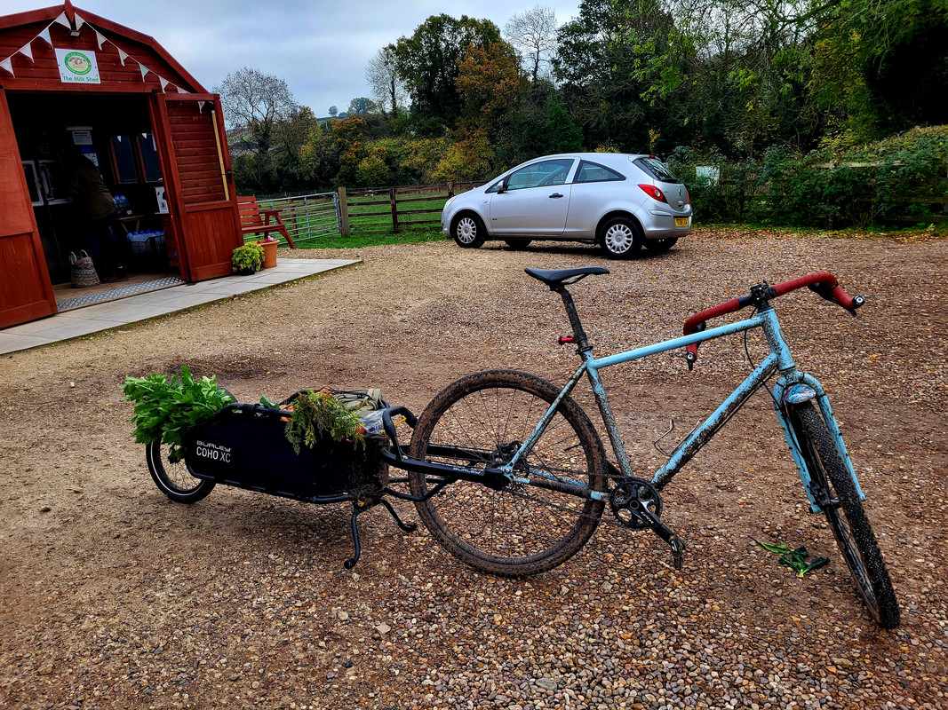

I have the Burley Coho XC
burley
It's great. One wheel feels good on corners and the suspension is a godsend for potholes when fully laden.
The two best bits are the ability to attach/unattach with one hand, and the kickstand which enables the trailer, or the bike/trailer combo to stand unaided.
