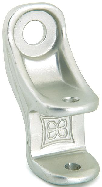

jaminb, how have you mounted the trailer to the big dummy?
envious of your front rack, would love one but wouldn't be able to store mine where it lives in the garage
Posted : 01/05/2020 2:07 pm
Posts: 859
benp1
In that picture one of these on the rear wheel skewer
with one of these inserted in the draw bar of the trailer (compatible diameters)
https://www.amazon.co.uk/Burley-Kids-Hitch-Connector-Round/dp/B001GSQXUG
It is a bit of a pain connecting underneath the pannier so I have bolted another hitch further back through the rear frame behind the back wheel. This is an experiment in progress but i think this will be for lighter loads only as it doesn't appear quite so rigid and I think there is the opportunity for some snaking to occur - i would hate to shed a load of logs or worse beer.
Posted : 01/05/2020 2:24 pm
Posts: 2583
@jaminb that hitch is along the lines of the carry freedom hitch. I'd really recommend this type of hitch. ie, something small that stays on the bike at the axle and then a "rubber" flexible connector. It means there's not rattle from the hitch itself an axle mount means the bike behaves like a bike still. The only downside is the slight flex in the rubber part means you can feel the trailer pulse a little when it's loaded up. It certainly makes you realise if you aren't pedalling smoothly!
