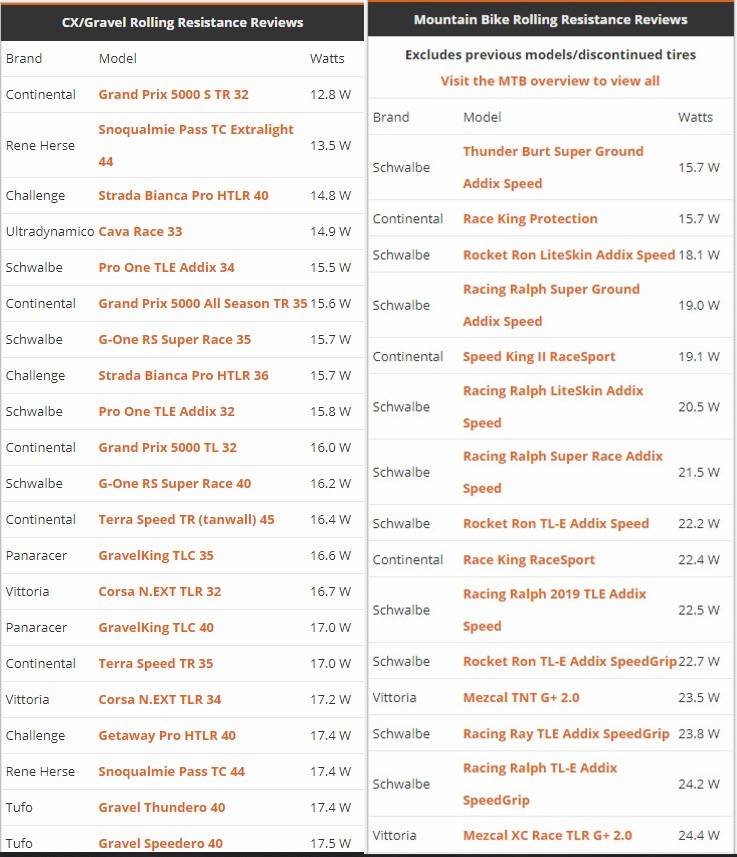

The trouble with Tyre Rolling . Com is that you can’t compare mtb and gravel tyres unless you pay so you can see all the pressures
It’s quite compacted comparing sizes any way. A bigger tyre will have less rolling resistance than a smaller one at the same pressure. But as the bigger tyre is heavier, less aerodynamic and  less comfortable at the  same pressure it’s useless comparing at the same pressure
