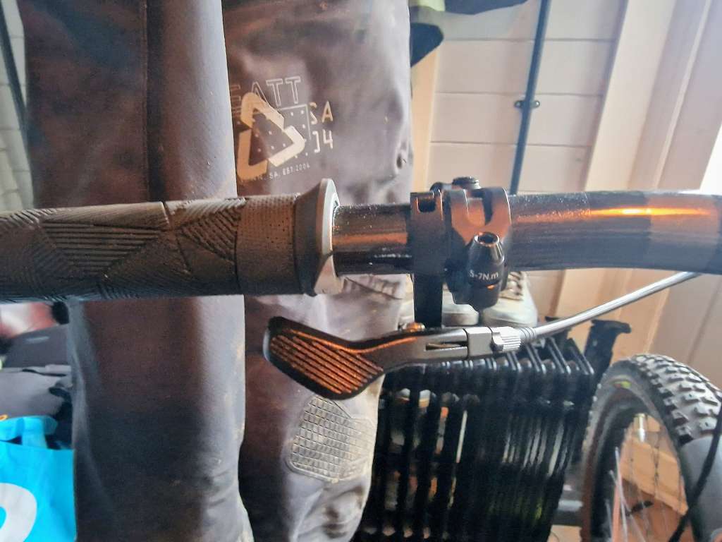

Managed to get a 200mm Brand X in my large Big Al
20231228_124140~2
Whatever you do don’t choose the Brand X lever against the £20 Shimano MT500. The Shimano is far better built and much better to use.
Not tried a Shimano lever, but when the Brand X was so cheap, seems daft spending extra and the lever seems absolutely fine to me
20231228_123816~2
Posted : 28/12/2023 12:49 pm
It does work, I had both at one stage. The Shimano lever feels at least twice the price in terms of build and function, because of its design, with a wheel/bushings around which the cable goes.
The Shimano one is £17 despite coming with SP41 outer and a coated cable. The Brand X is £25 in the scenario that the OP mentioned, ie buying a OneUp.
If I bought another Brand X dropper I would buy a Shimano lever and sell the Brand X one for £20.

So, the Fox Transfer + Shimano lever kit has arrived.   I haven’t heard from Magura yet but will give them a could have days seeing as they may have shut for Xmas.  I’ll have the Occam apart (easier to remove the BB for the cable routing) at the weekend to add the post.
I’m thinking I might sell the Vyron you know, either the current one as spares / repair or a replacement.  Having played on juniors bike having a lever feels more tactile and natural than a button.  Note 100% sure yet though.

I tried the Shimano level (the XTR one MT800), very nice lever and comes with nice cable, but runs very close to the handlebar (i-spec EV version), so don't find it that great to use when compared to Bike Yoke Triggy.
Wonder if the band on version of the MT500 sit further from the bar?
That said you can get MT500 and MT800 levers for very good prices and inc. cable is good and would still have one over a brandx etc.
