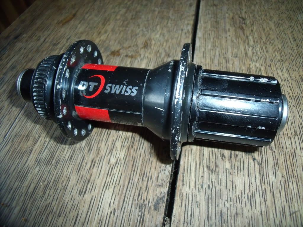

@Northwind see the seal photo http://imgur.com/a/MiY2C and full assembly http://imgur.com/a/6rZXN (both images are zoomable)
The seal is sticking out from the hub body for about 0.5mm, but the connection with the freehub is very good and feels right.
Posted : 02/10/2016 10:56 pm
I'd want to take a look at one of mine to be 100% but I think the seal is standing a bit proud. But also, there shouldn't normally be that much of a gap between seal and freehub. That could just be that the freehub's not quite fully in place in the photo though so I don't want to read too much into it.
Posted : 02/10/2016 11:04 pm
That's a good picture with details - thanks! And the freehub is as close to the hub body as it was possible. I'll try whacking it in a bit further tomorrow.
Thinking about it a bit more - angular bearings suspect does make sense, but these should not block the freehub from moving when under load. And freehub barely moves when QR is locked. Thus suggesting it is not just bearings - something else is creating friction on freehub.
Posted : 02/10/2016 11:14 pm
Looking on this image:
[img] ~original[/img]
There should be almost no gap between freehub and hub body. I'll do more whacking!
