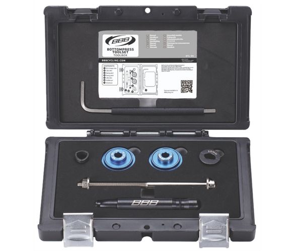

Because there are now 4 bikes in the cave with various press fit BBs, I invested in a BBB BTL-95. Makes the job very easy.

Onewheelgood is that kit removal and installation?

Posts: 4397
@stennah, yes, removal and installation of both BB30 and BB92.
