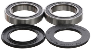

I'm trying to locate some replacement bearings for my custom frame's BB shell.
I've measured them at 37mm OD, 24 ID. I believe the ones fitted are Phil Wood, but there are a few different makes out there
So, can anyone supply a link for some like these in the pic with the protective dust/dirt covers?
There's a few on [url= http://www.chainreactioncycles.com/Categories.aspx?CategoryID=145 ]CRC[/url] but there's no specs on the listings
Cheers

Try www.enduroforkseals.com or www.BETD.com.
Posted : 02/02/2011 2:43 pm
It's not BB30 you have, as that has a 30mm ID/axle. It will be BB92 most likely.
Standard bearings from a bearing supplier will work.

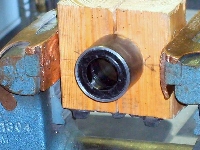

Dougal I think this is my biggest difficulty - I don't know what I have to look for
Here's another shot of the BB shell with the Bearings fitted. It's the dust cap I need too - it goes all the way down, more than the ones in the 1st pic I posted
I am using a standard XT crank if that helps
Andy - cheers for the links, they look good
