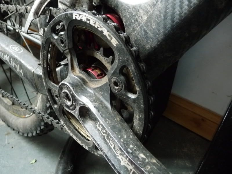

Heres my bash option,
22 - 36 up front. The bash is exactly the same od as the chain on the chain ring.
Posted : 26/05/2011 9:01 am

rick - what bashguard is that? I run a superlight 32T BBG bash outside a 36T ring, the bash is a few mm smaller in diameter than the chain on the ring but just large enough that it stops the chain falling off to the outside and I'd have to be extremely unlucky for the bash to ever take a hit.
Posted : 26/05/2011 1:27 pm

Here you go:
Posted : 26/05/2011 2:02 pm

Ah. cheers Rick, that looks pretty lightweight but still fairly strong (Alloy, I presume?) but best of all should be a better design better for shedding mud than most. I've got a (chunkier) alloy Race Face bashring fitted to a mini DH bike with a modified MRP type 3 that covers the 36T ring by the same amount as yours to give better ground clearance for its very low BB height (12.6")

Actually came off mrsRickmeister's Genesis to replace an ugly E13 Polycarbonate of the same diameter but 5-6mm thick. I like it a lot better, it is light but solid too
Just been on CR to find one and its[url= http://www.chainreactioncycles.com/Models.aspx?ModelID=40422 ] HOW MUCH ![/url] Like one of the reviews mentions, Light, Cheap, Strong.. pick two. Its is well made, light and strong as well as looking good.
If it didnt come with the Genesis, I would be looking at knocking all the teeth off an old 44t ring and using that....
