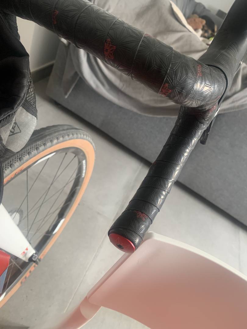

You don't need the cheat strip behind the lever if you use the right technique
yep no cheat strip on my pic, I actually think it’s makes it harder, if they’ve been a bit stingy with the tape and you cut a piece off for that cheat.
