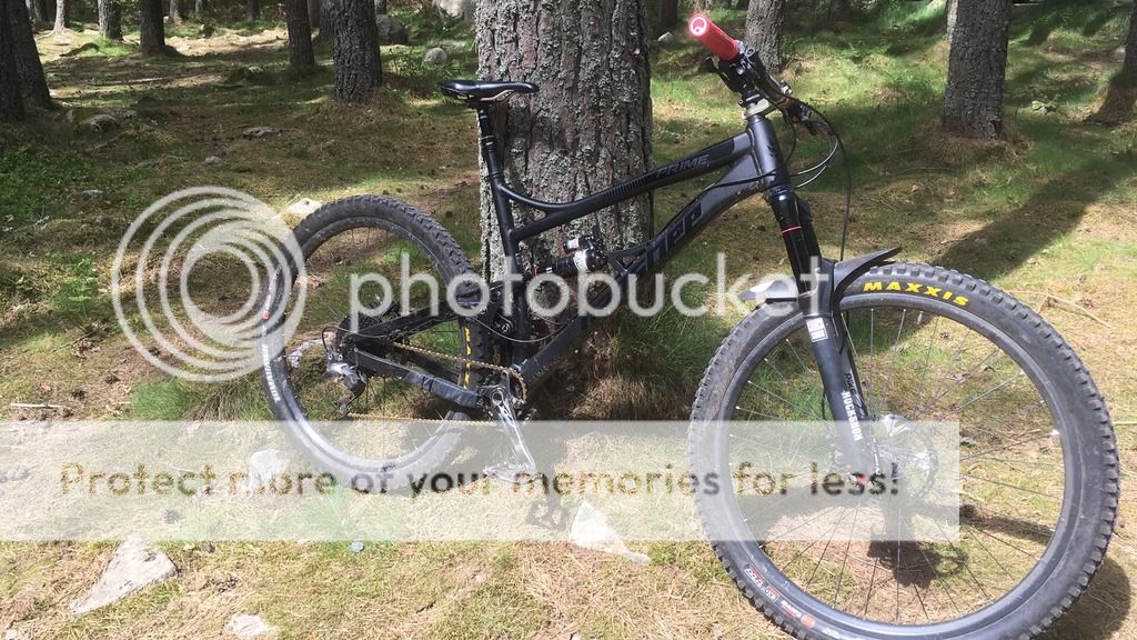

Looks like Tidworth from that picture?
Posted : 26/03/2017 2:36 pm
Looks mint..
Aston hill?
Posted : 26/03/2017 3:00 pm
 momo
Posts: 2098
No, that's the downhill mecca known as Sherwood Pines!
Posted : 26/03/2017 3:41 pm

Posts: 3353
Winter is coming, added some protection to keep the worst of the crap out of the bearings.
[URL= http://i1097.photobucket.com/albums/g341/kiwijohn42/4CB85771-89D7-46B1-A271-5FF682AFB586_zpsv7ukpq2l.jp g" target="_blank">http://i1097.photobucket.com/albums/g341/kiwijohn42/4CB85771-89D7-46B1-A271-5FF682AFB586_zpsv7ukpq2l.jp g"/> [/IMG][/URL]
Posted : 09/05/2017 11:47 am
Posts: 3887
I have pretty much the exact same thing in the back of mine, though I have the bottom bit on the inside of the chainstay cross brace. Keeps most of the crap out of the bearings and links as intended.
Posted : 09/05/2017 11:55 am
