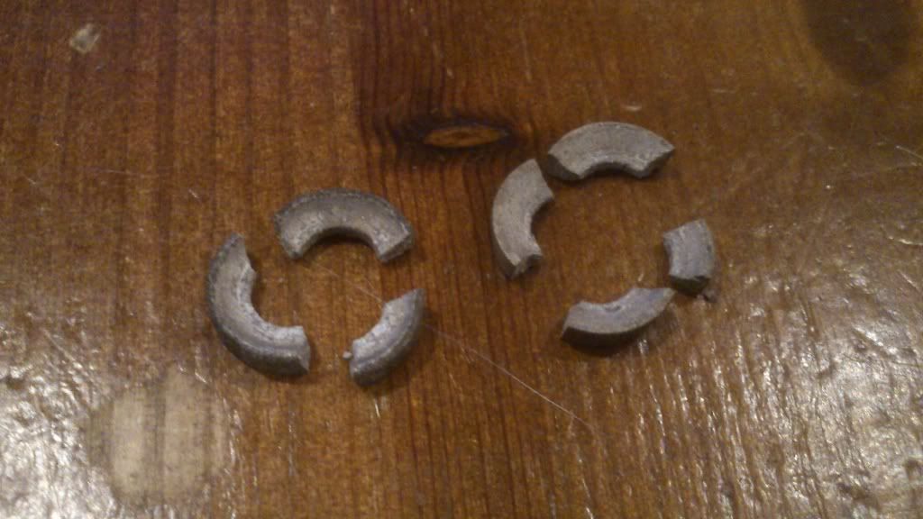

Noticed my rear brake was rubbing a little today - being of the Avid variety they need their fair share of frequent adjustment, so I thought nothing of it as I got the allen key out to centre the calliper.
However when I undid the calliper bolts the CPS washers just fell apart!
Is it normal for them to fail like this? Possible causes? The cold? Over tightening? The slight lateral play I have in my rear wheel?

Mine broke...didn't notice until I was removing them and assume age and overtightening. Same that come with olde brake blocks if you have any about.

Just replace them with some normal washers that come as close to the height of the male and female part combined.
I have done it as I was fed up of buying replacements. I haven't had any rubbing issues. Just set them up as you would with the cps washers.

A trip to your lbs should see you sorted. Most shops will bin loads on v- brake blocks everyday that have the washers you need.

You've got a cone and a bowl that need to go together, both are removable washers. You can remove both and find a spacer such as a washer or just use some v brake washers which are the same. I've done both on varying bikes.

Don't quote me on this but I seem to remember the combined height of the cps washers was 5.2mm and I replaced them with 2x m6 washers that measured 2.4mm each totalling 4.8mm. I can check these measurements tomorrow if it will help.

Had these break on me twice now. I torque to the minimum spec and crack, fall apart.
Not on new ones, but those that have been on there some time and I readjust or have taken the caliper off and reassemble.
