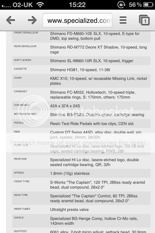

Right, I am getting in a bit of a pickle. I am trying to source a replacement BB for my camber (sorry for ye new post but did not have much luck with the other).
My bike is fitted with fc-m552 hollowtech cranks. I have worked out that the bottom bracket shell is 73mm but the spesh web site spec calls up a bb-es25 octalink spline bottom bracket.
I thought hollow tech and octalink were NOT compatable??? Am I going mad??? Here is a screen shot! Would some kind soul please help me work out what I need .....Thanks 🙂

original hollowtech were basically octalink fitting cranks with hollow arms, hollowtech 2 are external bearings
Posted : 20/11/2012 3:35 pm
Posts: 18
Ignore the spec and look at what you've got - if they're FC-M552 ([url= http://techdocs.shimano.com/media/techdocs/content/cycle/SI/SI_1LV0A/SI-1LV0A-001-ENG_v1_m56577569830706598.pdf ]http://techdocs.shimano.com/media/techdocs/content/cycle/SI/SI_1LV0A/SI-1LV0A-001-ENG_v1_m56577569830706598.pdf[/url]) with pinch bolts on the non-drive side then they're HTII and you just need a set of standard HTII BB cups

Weird - the ES 25 is, indeed a splined octalink one but I thought the M552 chainset was a hollowtech 2 so took the external bearing type of BB.
It is possible there was an OEM 552 which was old style hollowtech (octalink).
have you any photos?

I'm pretty certain that Hollowtech on the cranks you have is just in relation to the construction of the cranks. ISIS is the bottom bracket type.
Hollowtech II is the external cup type bottom bracket that rely on the cranks have an integrated axle.
Take a look at the cranks and see if the have a hollow axle or if the cranks are bolted in at both ends.

M521 is an octalink set (ie Hollowtech, rather than Hollowtech 2). Without actually looking at the bike and what's on it I wouldn't guess, but I wouldn't trust the Specialized published specs on either part!

Right, UK spec for that bike is [url= http://www.specialized.co.uk/ie/gb/bikes/archive/2011/camber/camberexpert#specs ]HERE[/url] and is clearly wrong as the ES25 & M552 are incompatible.
Looking at the piccie in close up shows a hollowtech 2 chainset (a hollow axle all the way through).
Any Shimano HT2 BB will do (other brands are available).

Cheers Nobby ... Dug out a pic - yeah definitely hollow through one side, only one crank bolts off, and the other side has a plastic cap with star shaped drive in. So I think I am clear now! Thanks for all your help guys

Given the pic and the spec sheet disagree above, I'd just take it apart and have a look. If it is Octalink, you need to take it out to get the size anyway.
Also since you haven't taken it to bits yet, how do you know you really need a new BB and that there isn't something else going on such as something just being loose rather than worn out?
Edit: pic arrived while typing, I'd still disasemble before ordering bits to be sure it was the only issue

As you have already surmised that is a hollowtech II crank set and any f the externl hollowtech II BB's should fit.
