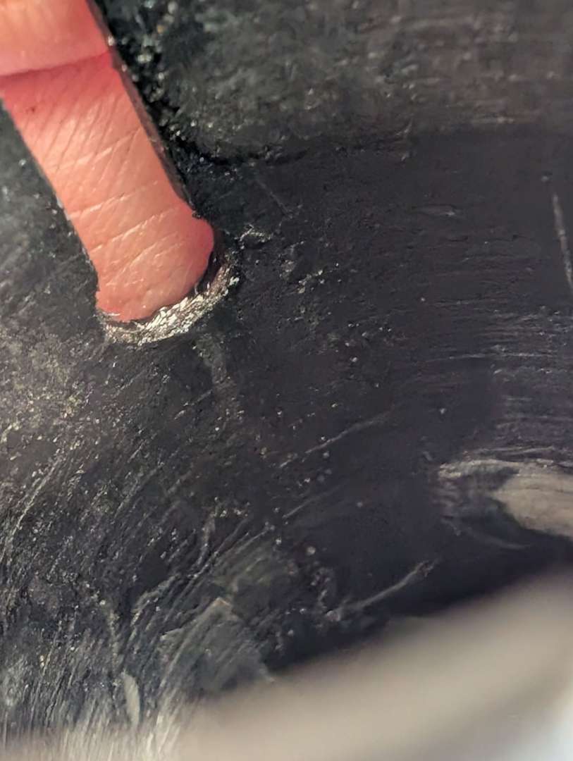

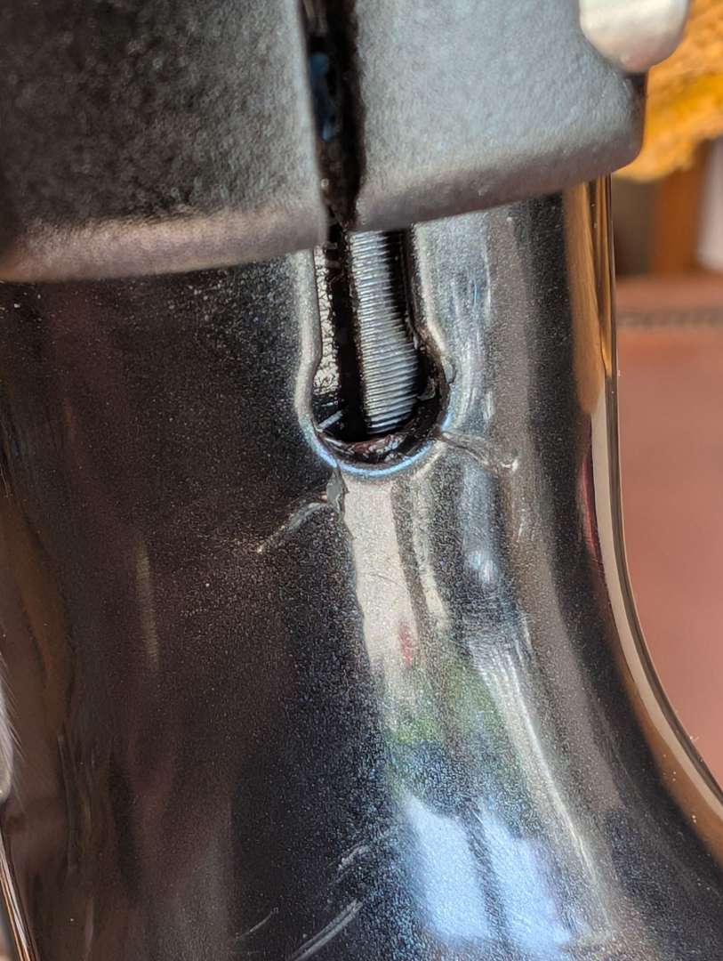

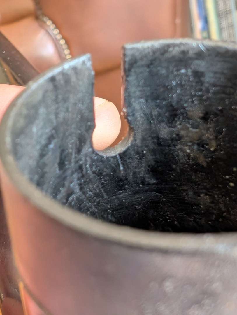

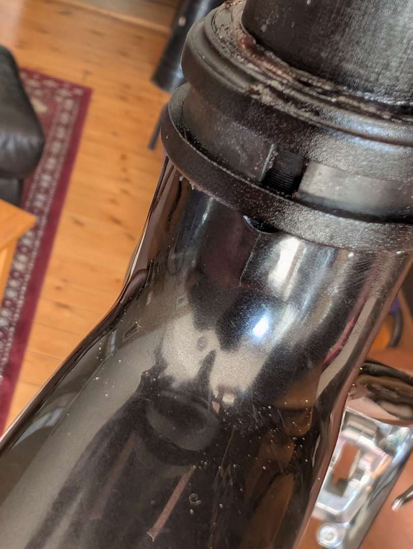

Both front and back slots on a carbon CX frame :(. Looks like it's due to a 30.9 post being run in a frame that is 31.6! I've fitted a looong 31.6->27.2 metal shim and a 27.2 post for now but am undecided about what to do long term.
Front outer
Front inner
rear inner (not convinced this is a crack)
rear outer (could just be paint this side)

A carbon fibre repair kit would sort that out but I’d stick to one slot. They are exceptionally large and two of them? Use a good quality clamp afterwards like a BBB Strangler or a Madison Elite. This is of course after contacting Boardman, just in case!!

For a repair I'd be thinking sand back, drill end of crack then build a reinforcing ring around the whole post but below where it is sized for the clamp. Then blend in and paint. I will contact Boardman to confirm the post size but this is a 2016 model frame that was NOS in 2022.

I would drill the ends of the cracks and just keep an eye on them. If you've sleeved it down to 27.2 mm, that should spread the stress away from that area.

Yep I'd be happy enough running that after drilling the ends to stop it propagating further and just doing a quick epoxy repair.

Can you fit a bigger cleat clamp like one that’s twice as deep. Maybe drill a small hole at the bottom of the crack to stop it cracking further (like on plastic kayaks that have cracked)? I reckon as long as you’ve got enough post inserted you should be ok.
